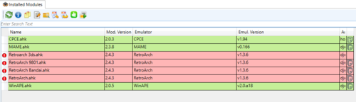

I just got my  Hyperspin setup but retroarch will not run with anything associated with this emulator.  inside of rocket launch Installed modules section it shows error and some says module have duplicate ID and some others says invalid CRC, module might of bee tempered. I tried using latest retroarch but issue remains the same. i am thinking it has to do with modules that came with rocketlaunch are the issue here maybe? i even tried installing the latest Rocketlauncher as well.

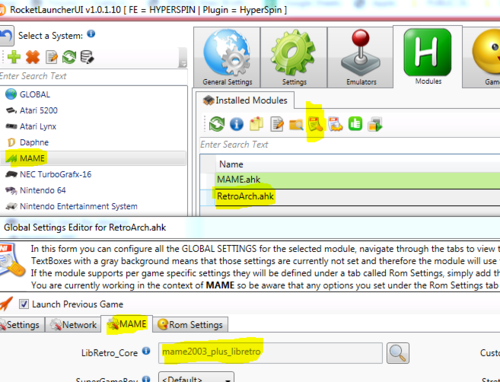

No need to duplicate RA modules. Just the 1 retroarch.ahk will run everything just fine.
You just have to specify what core to use in the "edit global module" settings. Here is an example of mame:
You must set this for every system that uses RA by selecting it in the left pane, then add appropriate core name.
