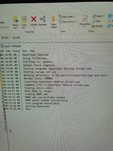

skibadizzle Posted December 8, 2020 Author Posted December 8, 2020 I'm at work at the moment but will check the linked post later on today. I've attached a quick photo of the startup log below just in case that helps at all. Looks like it's launching via hyperspin rather than RL, how would I change that if that is the case? I'll have a look this afternoon to see if the files are read only (boy will I feel dumb if that's what it is haha) and also try changing the settings.ini manually. Glad you agree on restarting as a last resort, really don't want to setup the controls again if I can avoid it. I have all the artwork, videos and sound files in the correct folders etc so can just back them up if needed.
