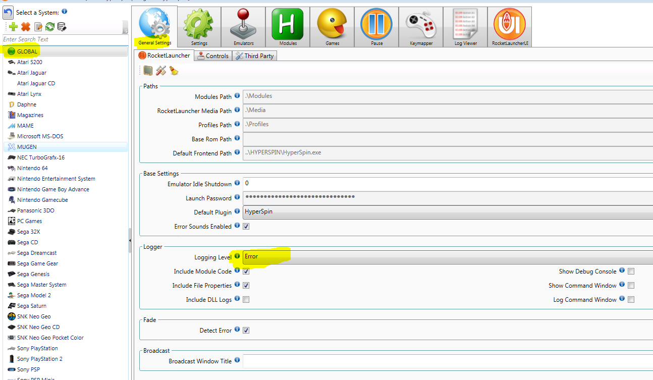

If you still think it's unusually long you can set the RL log to "troubleshooting":
Then try to run a game you feel is slow. The log is massive but the actual launch stuff is near the bottom. All the actions in the log have timestamps so you can in fact see at which step it is taking a couple of seconds.
** Just remember to turn "troubleshooting" back off for the log after because just having it on can slow the launch.

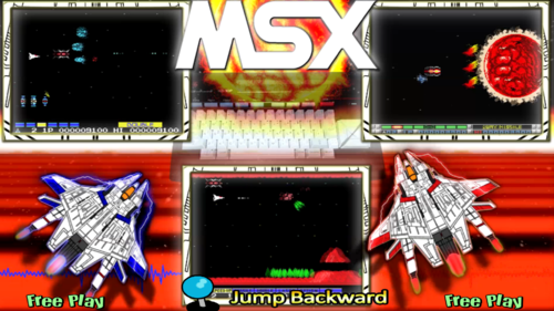

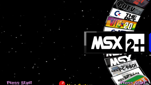

O.K  Here is what i mean by Main manu.
When you launch the HS it takes you to this "main menu" wheel that shows all the different systems.
Lets use this Pic 1  and Pic 2 as a example.
if i scroll up or down through the wheel and lets say i decided to stop at MSX 2+.
in a normal circumstances, soon as I stop at  MSX 2+, right away it goes into  system theme (see Pic2). with out me choosing to do so.
what i would like my system to do is, if i decide to stop at the MSX 2+, i want it to stop there and  that's it. not automatically transition to the theme itself.
is it  possible?

Also,
for loading issue, it was already set it as  "troubleshooting". maybe thats why it took forever to load.
I set it as "OFF" and it did seem to improve the speed.
Thank you
Yeah ok, not really possible though.
If a theme is there, HS will load it.
You could try just using “default” main menu theme instead of each system. Then it would only change when you actually entered a system wheel. Main menu would never change though!
