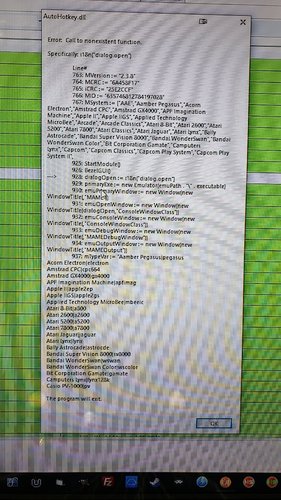

SaturnMS Posted December 15, 2020 Posted December 15, 2020 Anyone else ever come across this? can't figure out where the problem is. I saw another reference to dialogOpen:= i18n("dialog.open") that referenced the shared.ahk but that shecked out fine on my system.
Spawk Posted December 16, 2020 Posted December 16, 2020 In RLUI set the log to "troubleshooting": Then try to run a game one time. It will create a log here: Take that log and upload it to pastebin.com It will create a link and you can share the link here. Maybe RL forums may be better place to post it. HS log may have useful info too? ** turn off troubleshooting when finished as it will slow down loading in general.
SaturnMS Posted December 17, 2020 Author Posted December 17, 2020 https://pastebin.com/8kHdDtmB ok, here is the log file. much thanks for any help you can provide!
Spawk Posted December 17, 2020 Posted December 17, 2020 start with an updated mame module from here: http://www.rlauncher.com/showthread.php?6201-MAME-v0-212-don-t-launch-with-RocketLauncher&p=44551&viewfull=1#post44551 Replaces ..\Rocketlauncher\Modules\MAME\mame.ahk Need this for any version past .211
