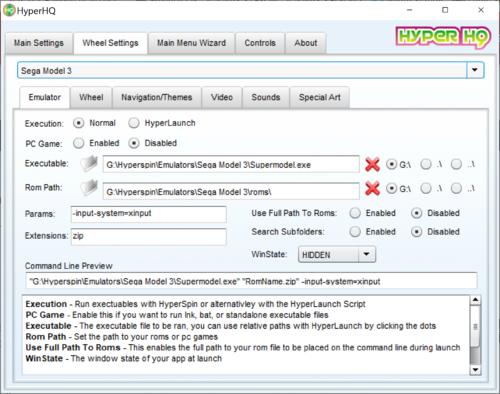

I need help concerning emulator params under HyperHQ.
I would like to launch Supermodel with some arguments as you can see in screen below:
I tried everything, launching it using HyperLaunch (so RocketLauncher) or in normal mode, I even tried to enable PC Game but nothing works!
I want to launch Supermodel using these parameter because I play using a Xbox360 wireless controller, support is better using XInput. Launching game manually using CLI is working, I can tell because rumble is automatically activated on Xbox360 Controller using XInput. But everytime I launch a game on Hyperspin, rumble isn't activated. So seems like parameters aren't applied.
Using BAT files like for Daphne for example, should works but I don't want to create a batch file for every Model 3 rom.... Can you please explain me what I missed concerning params on HyperHQ ?
