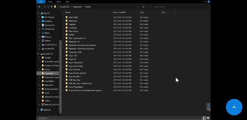

adamg Posted March 23, 2021 Posted March 23, 2021 Hey man, I have a very basic guide that might be of use to you. It is an older video but should help you with most systems as retroarch runs many. It will also walk you through a very basic install of Rocketlauncher and HyperSpin. Once you watch it, it may help you make sense of what is on the drive. As an aside, there should be a folder on the drive called Media found in the HyperSpin folder. That should be something you can copy paste into your new hyperspin directory and get the media. If you want, post a file directory and I can help make sense of it as best I can.

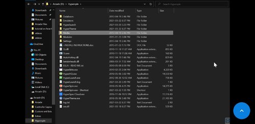

10wrxing Posted March 23, 2021 Author Posted March 23, 2021 Awesome, I'll take a look at that tomorrow. Here's a screenshot of the directory.
10wrxing Posted March 23, 2021 Author Posted March 23, 2021 I have Hyperspin on the external drive, as my idea is to clone it to a backup once this is setup. I have a shortcut on the desktop leading to the drive. Is this what you want to see? PS. I just did a google search for the name Chris Upchurch, and you guessed right. Found some YouTube videos and it's the same person as the videos on the hard drive.
adamg Posted March 23, 2021 Posted March 23, 2021 The picture you posted is perfect. You have the start of a very good setup right there. Just need to sort out some backend stuff and I bet that thing works great. Would you ever be available to meet with me in discord so I can walk you through stuff?

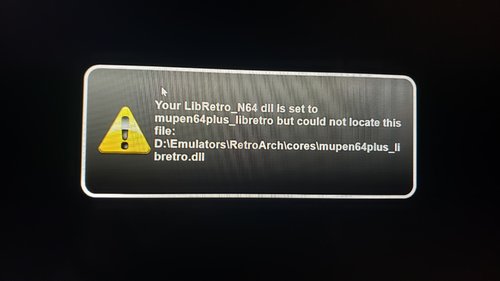

10wrxing Posted March 24, 2021 Author Posted March 24, 2021 Just tried to setup N64 and NES, both are giving me similar issues as seen in the picture. Any idea?
adamg Posted March 24, 2021 Posted March 24, 2021 Yeah you need to do the entire retroarch setup again. Need to update the cores.

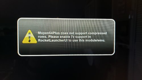

10wrxing Posted March 24, 2021 Author Posted March 24, 2021 I have done that, and now it's giving me this error instead. Do I need to uncompress them? I don't see an option on the Rocketlauncherui to enable the 7z support
adamg Posted March 24, 2021 Posted March 24, 2021 Go to Global in the left side menu, select Settings in the header menu. Then the 4th box should be for 7zip. Set Enabled to True and make sure to setup the exe and the extract path.

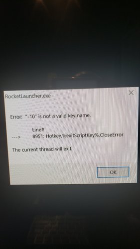

10wrxing Posted March 24, 2021 Author Posted March 24, 2021 I had some of it working again. Now I'm getting this error, and I've deleted Rocketlauncher and reinstalled it and I still get this. Totally lost now.
adamg Posted March 24, 2021 Posted March 24, 2021 Lol what have you done. You probably need to stop till I can help again cause I just think you are making it worse.
