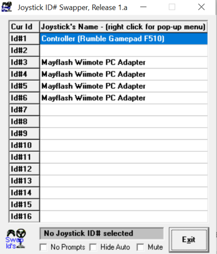

Torden Posted July 21, 2021 Posted July 21, 2021 I use this nice little app called JoyIDs. Works on the fly:
