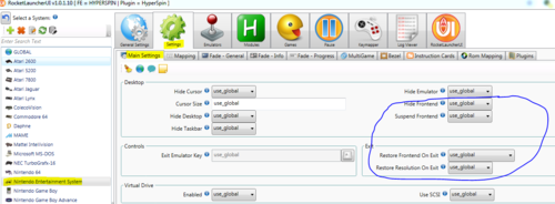

Spawk Posted October 19, 2021 Posted October 19, 2021 I am not entirely sure why some emulators seem to load up behind HS instead of in the forefront. There are some options in RLUI that may help the situation though:

Spawk Posted October 20, 2021 Posted October 20, 2021 Yes HS is a frontend (FE). When you select any game you are leaving HS and loading an emulator. So you may want to try setting "suspend frontend" to true so that HS is not in front of your game window. You may also have to set "Restore frontend on exit" to true as well so when you exit the game it will restore HS to the front again.
drjea2010 Posted October 20, 2021 Author Posted October 20, 2021 On 10/20/2021 at 3:27 AM, Spawk said: Yes HS is a frontend (FE). When you select any game you are leaving HS and loading an emulator. So you may want to try setting "suspend frontend" to true so that HS is not in front of your game window. You may also have to set "Restore frontend on exit" to true as well so when you exit the game it will restore HS to the front again. Expand Thanks for your continued help. Here's what happened. Setting BOTH to true froze the system and had both the emulator and HS showing as "not responding" after I had to hit ctrl alt delete. Setting just the first suggestion to TRUE turned the whole screen black but the game never loaded. I was able to get out of it by hitting "esc" on my keyboard. If I exit entirely out of HS then the emulator is not showing running in Taskbar. I also tried setting "hide frontend" (instead of suspend) to "true" and left "restore" to "true" -- that made my bottom Taskbar disappear and minimized HS and Nestopia. If I hit ctrl all delete HS, RL, and Nestopia all show running, and I can force the game open, but this still doesn't work like it should obviously. Setting "hide frontend" to true and leaving "restore" as "false" does the same thing. (Interestingly, when it flashes back to RL my arrow is on "fix ini files." I did that and didn't seem to make a difference. Again I'll point out, all my mame stuff works flawlessly and without issue. So I need to try a different nes emulator (even though all my research has told me nestopia is best). If so, what one? Link? Or are there more settings to try? Just throwing stuff out there. I went through Nestopia emulator options. "DIP Switches on Load" is checked....is that anything? Also in preferences, "autostart emulation" is checked, "run in background" is not checked. And "application priority" is set to "normal" rather than "above normal" or "high." Anything? Only other thing I note is in RL under emulators tab, "Nestopia" is listed as my default emulator but it doesn't say "global" behind it? I swear it did originally. Is that a problem and if so how to fix? Other suggestions? This is helpful...
Spawk Posted October 20, 2021 Posted October 20, 2021 hmmm, I use Retroarch for as many systems as I can myself so it's been a while since I looked at other emu's. Generally launching from HS should be exactly the same as when you launch from within RLUI. Those suspend options should rarely be needed if you are set up correctly. Can you check and make sure you have these settings correct?
