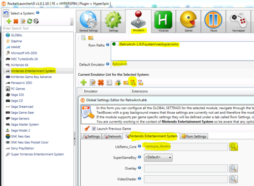

Spawk Posted October 26, 2021 Posted October 26, 2021 I guess I can share the core I have (from the downloader inside RA): nestopia_libretro.dll It goes in the ../RetroArch/cores/ folder. You can also compile your own core from here: https://github.com/libretro/nestopia You can read more info about options, other files and paths here: https://docs.libretro.com/library/nestopia_ue/ Since RA can handle many systems, you must specify what core to use in RLUI's "edit global module settings" tab:

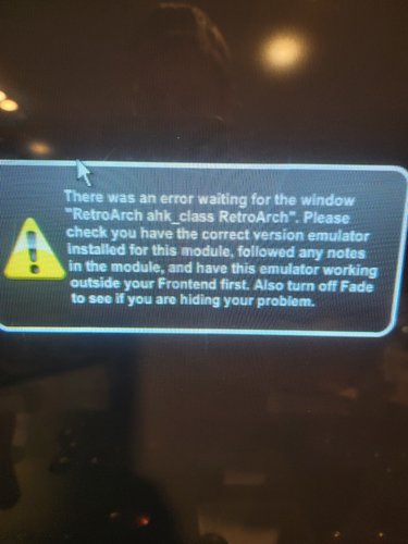

drjea2010 Posted October 28, 2021 Author Posted October 28, 2021 On 10/25/2021 at 9:43 PM, Spawk said: I guess I can share the core I have (from the downloader inside RA): nestopia_libretro.dll 2.97 MB · 0 downloads It goes in the ../RetroArch/cores/ folder. You can also compile your own core from here: https://github.com/libretro/nestopia You can read more info about options, other files and paths here: https://docs.libretro.com/library/nestopia_ue/ Since RA can handle many systems, you must specify what core to use in RLUI's "edit global module settings" tab: I did everything you said and got this message. When I try to run RA on its own outside RL and load a game it says cannot launch the core, even though it recognizes it. Any ideas? Again, this is on an old Win XP system. Not sure if I need a certain version of RA? Of the core?
Spawk Posted October 29, 2021 Posted October 29, 2021 If you can't get it to run in RA itself, then it will never run in RL/HS... Win7 (which I run) is almost dead so I really have no idea about WinXP. NES is seriously one of the easy ones for me though, almost every single emulator I try runs flawlessly. Just make sure they run in the emu first. Then try though RLUI (make sure to always check the "edit global module settings" for each system). HS should launch exactly like RLUI, if not you need to check the settings I linked in your other post.
drjea2010 Posted October 29, 2021 Author Posted October 29, 2021 So you don't have a specific read on this error or what it means/ how to fix?
Spawk Posted October 29, 2021 Posted October 29, 2021 No, that's a very general error message that will appear no matter what the issue is. If you want I can try to take a look at you RL error log: Did you put the "NstDatabase.xml" in ../RetroArch/system/ folder like it states in that second link?
Spawk Posted October 29, 2021 Posted October 29, 2021 And yes, there seems to be a specific version of RA for Vista/XP: https://www.retroarch.com/?page=platforms
drjea2010 Posted October 30, 2021 Author Posted October 30, 2021 21 hours ago, Spawk said: No, that's a very general error message that will appear no matter what the issue is. If you want I can try to take a look at you RL error log: Did you put the "NstDatabase.xml" in ../RetroArch/system/ folder like it states in that second link? I dl'd the xml and put it in the folder. Tried launching RA outside RL/HS. When it attempted to load a .nes file I got a pop-up in bottom left corner saying "could not load core," and now the message says "no core." But I literally JUST navigated to and set the core you shared yourself above. Core seems to be the issue. Any ideas? (If it helps, message in bottom left corner of RA note reads "1.9.12 msvc2010 - No Core" ) I did the same thing setting up RA on my computer dl'd my own core, and itb worked fine. But not on my arcade, without internet.
drjea2010 Posted October 30, 2021 Author Posted October 30, 2021 So I finally got it to work. Had to run a cord to connect arcade to intent, dl core there, and it works. Apparently can't just drop cores from other systems. Now to button map! Please be easy!
