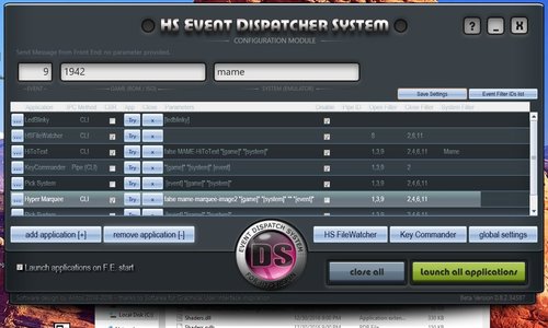

pinwizzer Posted November 21, 2021 Posted November 21, 2021 Hi, I am trying to get my cabinet setup, but cannot seem to get hypermarquee to work. I have been through everything i can find/read but nothing is working. As far as i can tell all of my directories with wildcards are setup correctly. When i click the 'try' button in eds, it does nothing on hypermarquee. While scrolling through games in hyperspin, it changes game names in eds, but again nothing appears on hypermarquee. I got it to display my default image, but nothing else. Can someone help me out, I am at the end of my rope and have nothing else to try.

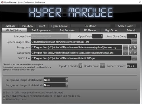

pinwizzer Posted November 24, 2021 Author Posted November 24, 2021 Here are my config files, anybody?

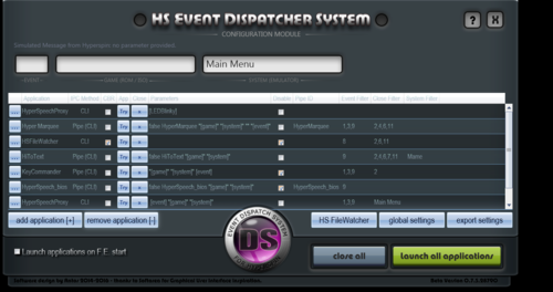

gigapig Posted November 24, 2021 Posted November 24, 2021 Here is my EDS settings if it helps. The other difference I could see was I have the named pipe ID as blank. You could post your Hypermarquee settings file.

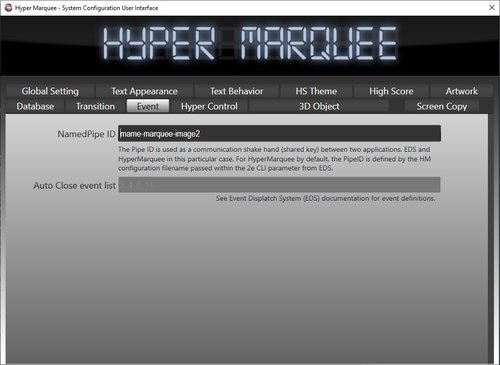

pinwizzer Posted November 26, 2021 Author Posted November 26, 2021 Thanks gigapig for the screenshot. I put my pipe id name into the pipe id field with no change. I also changed the properties on EDS and hypermarquee to always run as administrator. I have also tried all ipc methods and cbr combinations, no change. Attached is my settings xml file. When i put 9 in the event box, 1942 in game, and mame in the system box, and click the 'try' button next to hypermarquee, nothing happens. I assume it is supposed to launch hypermarquee with the 1942 marquee? I also watched task manager and it never starts hypermarquee. MAME-Marquee_Artwork_t6.xmlFetching info...
pinwizzer Posted November 26, 2021 Author Posted November 26, 2021 WOW! i tried one more thing for the night. I renamed the setup xml file to the same as the pipe call and pipe id, and it works when i hit try!! Thanks so much, i must have spent 20 hours trying to get this to work. AWESOME! i see i still have a lot of configuring to do, the image is double , but it works and even works in hyperspin.
