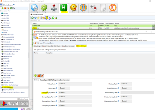

Naches Posted February 6, 2022 Posted February 6, 2022 I set up my controls in the ePSXe emulator and they work fine but when i launch through Rlauncher or hyperspin they dont work?? i cant figure out whats wrong
Spawk Posted February 6, 2022 Posted February 6, 2022 RL defaults to "Dual Shock" so any game that supports those should work. For any games that require "digital" you will have to make per-game settings in RLUI: Just click the plus sign, choose the game from list, then set gamepad type (1-4). Repeat for each game. I use to have a link for a thread on the RL forums that listed which games need which. The RL site has been revamped so all the links I had saved are broken. Should be easy enough to find though.
