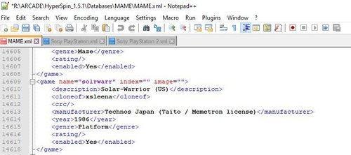

puleoarcade Posted February 20, 2022 Posted February 20, 2022 Been setting up and learning Hyperspin for the past couple of days, but need help on something. How do I mass rename the rom's description so game wheel shows the game name not the zip file name. RocketLauncherUI and MAME.XML both show file name is same as description.
Spawk Posted February 20, 2022 Posted February 20, 2022 Not sure where you got your xml from then. All that I have used are like this: You do need to make sure your xml matches your version though. A user named @r0man0 has an awesome tool named Mame List Generator (or something to that effect) that is very useful for this kind of thing. You can find it in the downloads section.
puleoarcade Posted February 20, 2022 Author Posted February 20, 2022 Used an old Dom's create XML program which generated the MAME XML. I just went to downloads and downloaded the mame xml complete file. Now trying to figure out how to remove the games in Hyperspin which I don't have ROMS for.
