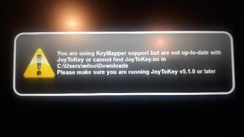

OrlandoOschino Posted February 9, 2023 Posted February 9, 2023 hi, can someone help me resolve this issue? thanks!
floatingyeti Posted February 10, 2023 Posted February 10, 2023 You need to change the path to the JoyToKey folder location.
OrlandoOschino Posted February 10, 2023 Author Posted February 10, 2023 Thanks, but change it to what?
floatingyeti Posted February 10, 2023 Posted February 10, 2023 Change the path to the where the JoyToKey application folder location. I think JoyToKey default is in User Documents folder but it can be placed anywhere. Right now Rocketlauncher is looking in your Downloads folder. It just needs to he pointed to the correct location.
