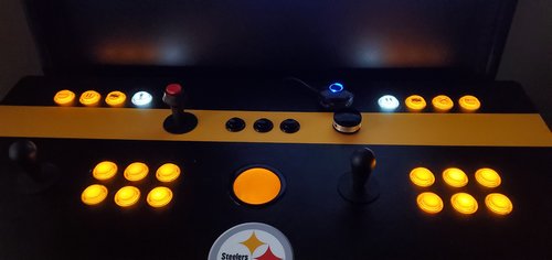

SidneyAtl Posted February 26, 2023 Author Posted February 26, 2023 Well... After many nights banging my head against this cabinet I finally have a solution to my problem. Hopefully my fix / workaround will help others if they ever have this odd problem. So... I went into RocketLauncher and looked at all the settings for Stella (Atari 2600) and noticed that the guy had configured. He was using a "Global config" for most of the emulators. Well... he had MAME launching the Atari 2600 as the default emulator. I changed that to Stella and was able to launch it fine from the wheel in HyperSpin. The only problem is that it was displaying the game in a really small window in comparison to the size of my screen. Setting "Full Screen" in the Stella config worked fine until you exit the game and then it went back to small. It was getting marching orders from somewhere else that I never found. Long story short, I disabled the bezzle by just setting the Bezzle enable option in the settings tab of Atari 2600 to False. I really didn't care for the bezzle he was using anyway. And now... Finally... I have full spinner, trackball and joystick control through Hyperspin. It took a while, but I learned a ton about how HyperSpin and Rocket Launcher work. Still not an expert, but much smarter than I was when I started. Thanks again Dark for all your help. I'll have to go see if anyone has responded to my post about setting up and configuring HyperSearch on the wheel. So glad to finally put this problem to bed... it was really driving me nuts!!
