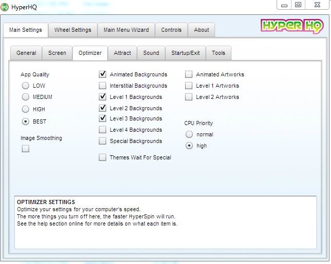

justintime Posted June 19, 2023 Posted June 19, 2023 Im trying to create a theme that has a number of Artwork Layers (Artwork1 and Artwork2, Artwork3), but also has a single video layer. I need the video layer to sit on TOP of the other two artwork layers, but no matter what I try I keep getting the video sandwiched between the 3 artwork layers. This is how I have it set up: <Theme> <artwork3 x="783" y="385" r="0" time="0" delay ="0" type="none" start="none" rest="none"/> <artwork1 x="650" y="113" r="0" time="0" delay ="0" type="none" start="none" rest="none"/> <artwork2 x="650" y="500" r="0" time="0" delay ="0" type="none" start="none" rest="none"/> <video w="550" h="540" x="360" y="356.3" r="-2" rx="-6" ry="-18" below="false" overlaybelow="false" overlayoffsetx="0" overlayoffsety="0" forceaspect="none" time="1" delay="0" bsize="3" bsize2="6" bsize3="0" bcolor="0" bcolor2="12763842" bcolor3="0" bshape="round" type="bounce" start="none" rest="none"/> </Theme>

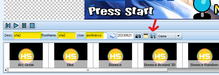

jesfknkrys Posted June 21, 2023 Posted June 21, 2023 You need to complete the below fields to save your theme. Here is the option for the "fade" <artwork1 x="200" y="155" r="0" time="1.8" delay ="1.4" type="fade" start="none" rest="none"/>
justintime Posted June 21, 2023 Author Posted June 21, 2023 For the life of me I cant get it to work. I tried your exact fade code and the image doesnt fade. It simply does what it has always done: It does NOT fade in, and also when I switch to next wheel item it randonly performs and effect "out" (such as bounce left, move right, zoom out, zoom in etc). Im using Artwork4 if it matters. Im using the latest HS 1.5.1 and this is on Windows 7 and on Windows 10. Same issue! I also got my HyperTheme issues resolved and managed to create a new sample theme from sracth with a fade effect on a standalone artwork image file, and same issue. Could my settings have anything to do with what Im experiencing? here is what I use. I tried turning on the ANIMATED ARTWORKS option ON, then the artwork4 in question doesnt even display.

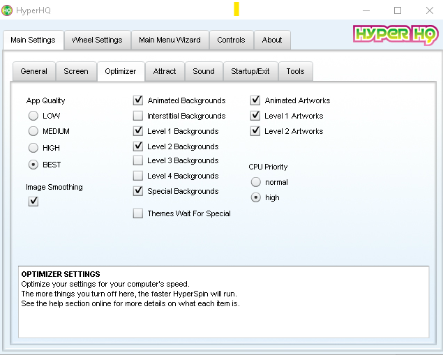

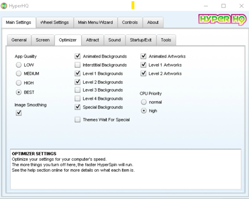

justintime Posted June 22, 2023 Author Posted June 22, 2023 Ok thanks a lot you helped me a ton. As it turns out, the issue was that I had the Animated Artworks option off. I turned it on, and it works correctly now. I know it's odd, but I did say I had tried turning this on before - and it didn't solve my issue. However it definitely works now after once more enabling that option.

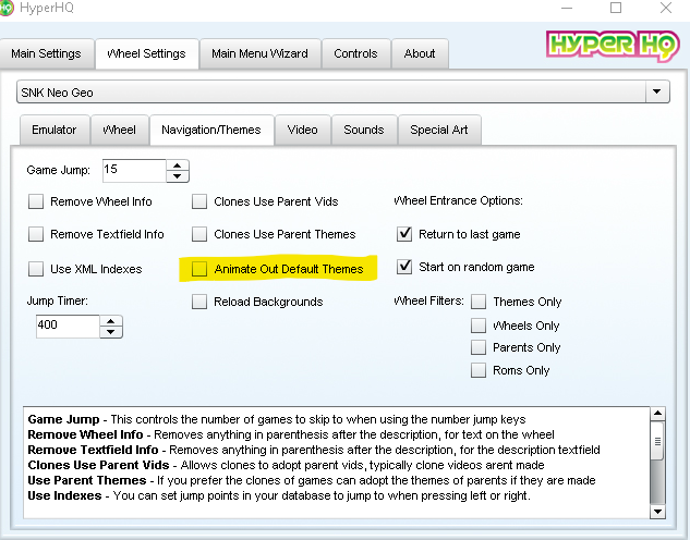

jesfknkrys Posted June 24, 2023 Posted June 24, 2023 I didn’t get the effects that you get when changing games. I have my zipped theme under the media “MAME” folder. The file name is “default.zip” It contains the theme.xml file only inside of it. My artwork is in the “artwork4” folder. Is this the same setup you have? Check to make sure this settings is unchecked for your system. Nevermind. I got the same results as you.
