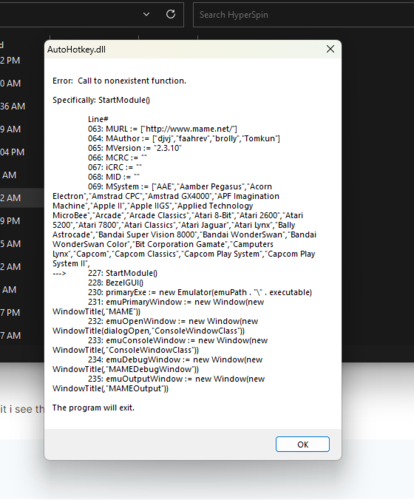

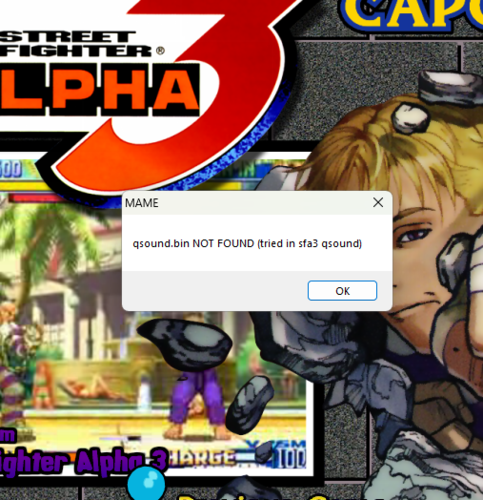

ro6ka Posted August 19, 2023 Posted August 19, 2023 Hello fellas I`m new at this and now have some kind of problem that i can`t resolve even with help of forum. First one I want to use original HyperLaunch but when i`m using it i see this kind of problem i tried mame from ofcial website version 0.241 and mameuifx64 version 1.75 Then i tried to use rocketlauncher , i finaly configured it with mameuifx64 version 1.75 but some games give me this error i think it can be problem with .ahk files taht storen in modules folder but , i can`t find new version of them the last one that i found was MAME_2_3_10.ahk

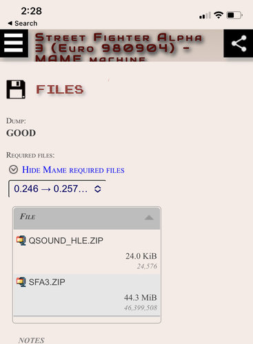

jesfknkrys Posted August 19, 2023 Posted August 19, 2023 You are missing the qsound. Do a search for qsound rom. It is needed for cps2 games.
ro6ka Posted August 19, 2023 Author Posted August 19, 2023 6 hours ago, jesfknkrys said: You are missing the qsound. Do a search for qsound rom. It is needed for cps2 games. okey thanks i found it , but now i need to copy \it to every game that don`t work or i need to copy it to some folder ?
jesfknkrys Posted August 19, 2023 Posted August 19, 2023 looks like you just need the qsound_hle.zip file in your rom folder.
