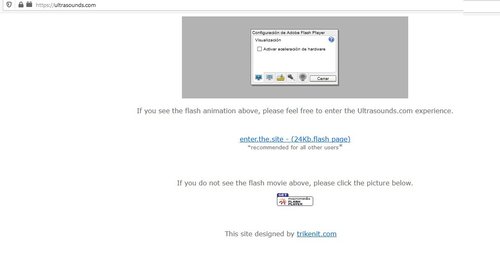

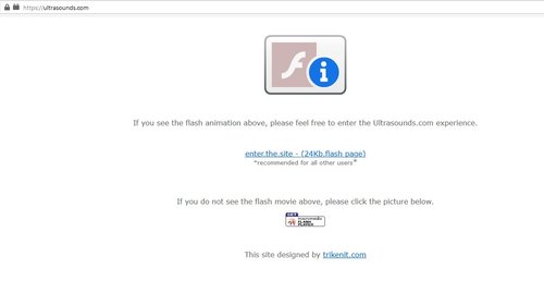

  7. Go to this site: https://ultrasounds.com/
  8. You'll see the Flash logo at the top of the page, meaning Flash Player is installed. See Screenshot 1
  9. Press right click over the Flash logo, go to Configuration, and uncheck the "Hardware acceleration enabled" (mine is in spanish). See Screenshot 2.
  10. There you have your videos running smooth.
