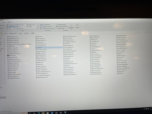

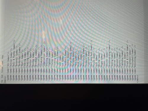

the reason i was thrown off and didnt already try that (i had previously found the genre.xml) was because it doesnt match my wheel exactly
there are categories listed in genre, the xml files are there, but they dont show on the wheel (for example All Mame.xml is in there)
how can i go about adding some of these categories and why would All Mane.xml not show?
