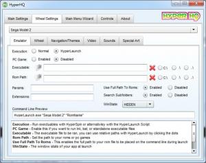

tonycawa Posted July 10, 2014 Posted July 10, 2014 Okay, so I got model 3 running good so i decided to install Sega Model 2 emulator. Currently its version 1.1a newest from nebula webiste. Works great outside of hyperspin. Works in hyperlaunch. Went into HQ added main menu wheel with submenu. Did the normal setup of extensions and rom path. Launch hyperspin and it shows up on the wheel with art (updated database and art from hypersync) when I select it to enter the submenu with all the games ....screen goes black and hyperspin freezes???? I have to alt tab to get out and close down hyperspin. I figure it must be something with a setting or somenthing having to do with the wheel but not sure where to start. Please help!
gigapig Posted July 10, 2014 Posted July 10, 2014 Remove those settings you added to HQ, extensions and Rom path, they are not required. Also remove any checks from the wheel filters.
tonycawa Posted July 11, 2014 Author Posted July 11, 2014 Did that no joy. execution=normal PC game=disabled Executable=path to the .exe Rom path=\ Params=none Exstentions=none Wheels settings=all boxes unchecked Still just goes black???
tonycawa Posted July 11, 2014 Author Posted July 11, 2014 Tried removing it from the wheel and re adding it leaving everything in HQ blank still goes black on me
gigapig Posted July 11, 2014 Posted July 11, 2014 execution should be Hyperlaunch, if your using that to start the games. The normal setting is for using Hyperspin to launch. Should be.
