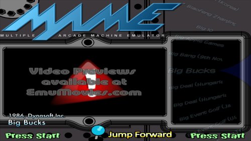

derpdederpdedurp Posted October 4, 2024 Posted October 4, 2024 Specifically Big Buck Hunter and Golden Tee Fore They work 100% in Mame, but will not show up in the wheel no matter what I do

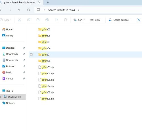

derpdederpdedurp Posted October 5, 2024 Author Posted October 5, 2024 17 hours ago, jesfknkrys said: Take a look at the below topic. I appreciate the direction! However, this is what my rom folder currently looks like. zips are all there and the chd files are within those folders
