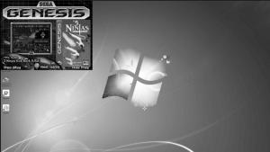

When exiting Kega Fusion, Znes, and FCE Ultra based emulators hyperspin comes up in a windowed view in the top conner my newer gen emulators like project 64 opens back in full screen. I believe it is a resolution problem but I have not found a work around or a fix for it, Im running RocketLauncher.0.0.9 and hyperspin 1.3.2.0. I would like for my emulators to exit back to HS in full screen mode they start the emulation in Full Screen any help would be appreciated

I have the same problem with the same version of Hyperspin 1.3.2 is it a bug ? If i use an emulator that has a resolution highter compared to the desktop resolution for examble Daphne 640 x 480 vs deskt res 640 x 288 hyperspin becomes windowed when i m exiting to the emulator- And is the same thing with Fusion....... Do you think that if i change the version of hyperspin all will work right ?
