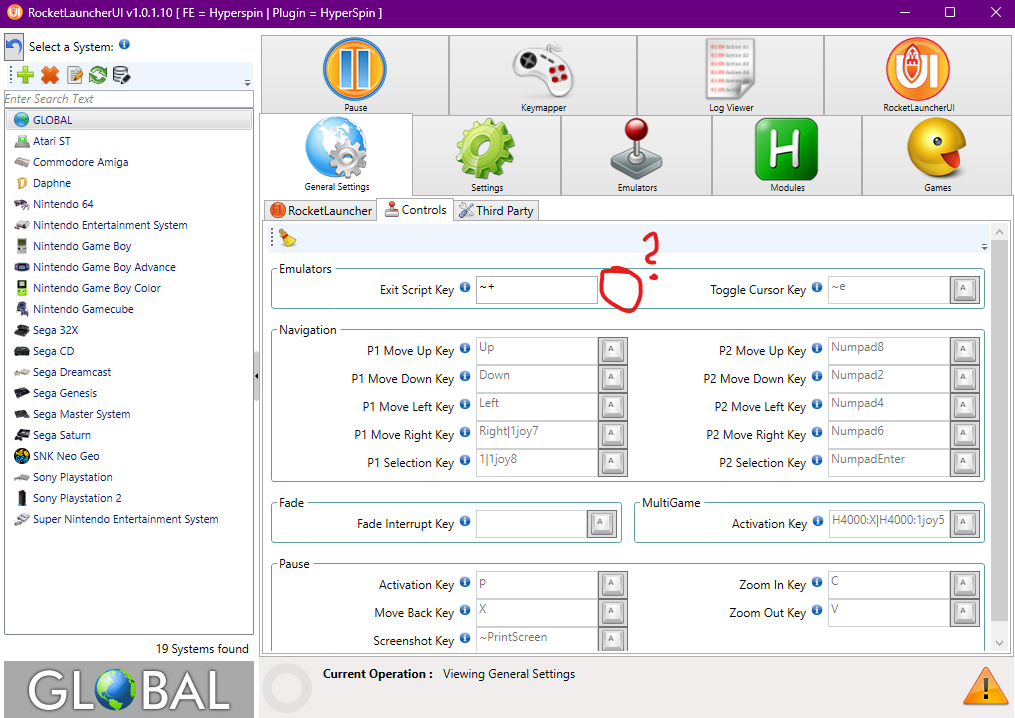

Tha_Warrior Posted September 14 Posted September 14 Hey, First of all im really happy this project goes forward. I downloaded the beta to see how it looks and works .  I set up 2 Systems but cannot launch any game. -> Do i still need Rocket Launcher? Or have the beta a new launcher on Board? Update -> Now it starts  I have a Problem with my old Hyperspin and damn, its to long ago , icant remember how i fix it . If anyone is interessted on my Problem -> I cant edit my Exit Script Key in Rocketlauncher UI . I miss a button. So every Time i want stop playing and go back to Hyperspin i need keyboard . I wanted to set the Exit button on Joy 1 R3 hold for 3 Seconds but cannot find it  Greetings from Austria

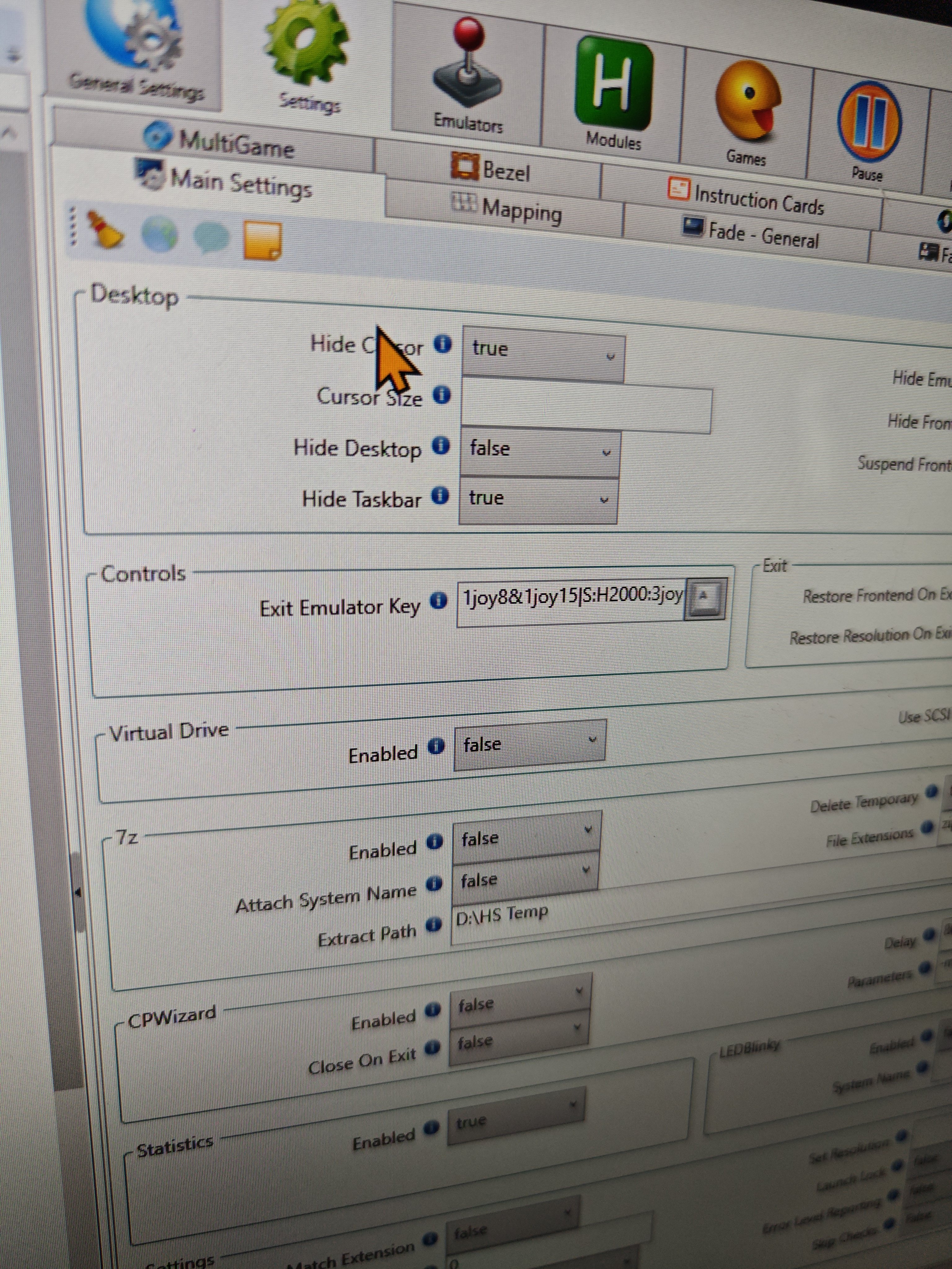

gigapig Posted September 22 Posted September 22 Hopefully you fixed this by now but just in case. You need to find the exit emulator key not exit script.
