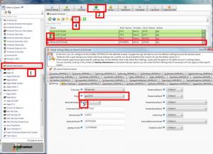

therealdealadam Posted August 14, 2014 Author Posted August 14, 2014 Don't suppose if you know how to get dx10 working in Naomi and Atomiswave through hyperlaunch?

rfancella Posted August 14, 2014 Posted August 14, 2014 Don't suppose if you know how to get dx10 working in Naomi and Atomiswave through hyperlaunch? For both those systems, are you using Demul? If so: Launch HLHQ and look at the screen below: Thanks, Ron Code Monkey and all around Command Line geek!If you like what someone has said or done for you, be sure and 'Thank' them. And if they changed your life, send them a Beer!
