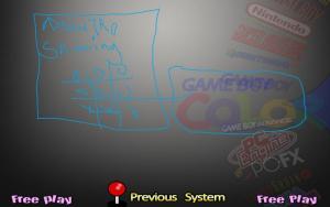

sonicboom88 Posted August 15, 2014 Posted August 15, 2014 hi guys could you help me some of my emulators are not showing consoles name image its happend since i renamed them in hyperhq because they was named wrong and was not showing settings in hyperlaunch hq Hyper Helper Ready To Help
penduzecat Posted August 15, 2014 Posted August 15, 2014 Hi, Your pictures from : HyperSpin\Media\Main Menu\Images\Wheel must have the same name of this file : HyperSpin\Databases\Main Menu\Main Menu.xml
sonicboom88 Posted August 15, 2014 Author Posted August 15, 2014 thanks it works but if i change for instance SNK Neo Geo CD to Neo Geo CD it then says cannot find Neo Geo CD .xml if i change the xml name will that screw things up? Hyper Helper Ready To Help

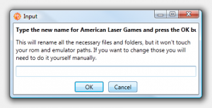

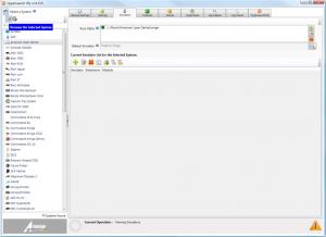

rfancella Posted August 15, 2014 Posted August 15, 2014 thanks it works but if i change for instance SNK Neo Geo CD to Neo Geo CD it then says cannot find Neo Geo CD .xml if i change the xml name will that screw things up? The proper name is "SNK Neo Geo CD". Rename your wheel image. Also be mindful of capitalization also. For the proper names of the systems, look in ...\HyperLaunch\HyperLaunchHQ\Media\Icons If you need to change the system name, do it through HyperLaunchHQ: When clicked you will get this screen: Hope this helps, Thanks, Ron Code Monkey and all around Command Line geek!If you like what someone has said or done for you, be sure and 'Thank' them. And if they changed your life, send them a Beer!

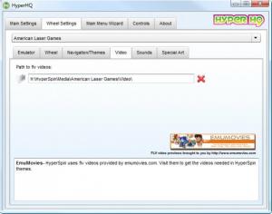

rfancella Posted August 15, 2014 Posted August 15, 2014 it says .\Media Are you refering to HyperLaunchHQ or HyperHQ. Check your path in HyperHQ like this: Thanks, Ron Code Monkey and all around Command Line geek!If you like what someone has said or done for you, be sure and 'Thank' them. And if they changed your life, send them a Beer!
sonicboom88 Posted August 16, 2014 Author Posted August 16, 2014 yeah sorry got confused its still not showing up Hyper Helper Ready To Help

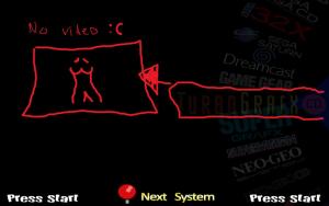

sonicboom88 Posted August 16, 2014 Author Posted August 16, 2014 thats not the problem the game videos play fine it when i am at the main menu in hyperspin its the console intro videos that are not showing on some of them Hyper Helper Ready To Help
ghutch92 Posted August 16, 2014 Posted August 16, 2014 Looks like it's missing a theme. How to Install HyperSpin and more RocketLauncher HyperSpin Startup Script
rfancella Posted August 16, 2014 Posted August 16, 2014 So right. I should have looked closer at the pic. Thanks, Ron Code Monkey and all around Command Line geek!If you like what someone has said or done for you, be sure and 'Thank' them. And if they changed your life, send them a Beer!
