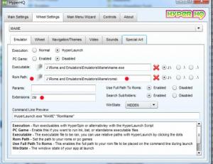

Did you generate an xml because you don't have a full set? If you have a full set there is an xml here or there should be one in the download.

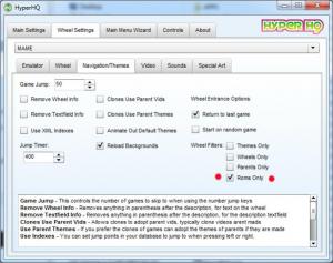

You may have some issues with your settings in HyperHQ which is the GUI for Hyperspin.
Try removing any wheel filters that are set. If you want to filter your Roms by Roms only you need to put in the Rom path and extension, so Hyperspin knows where to look and what for.
