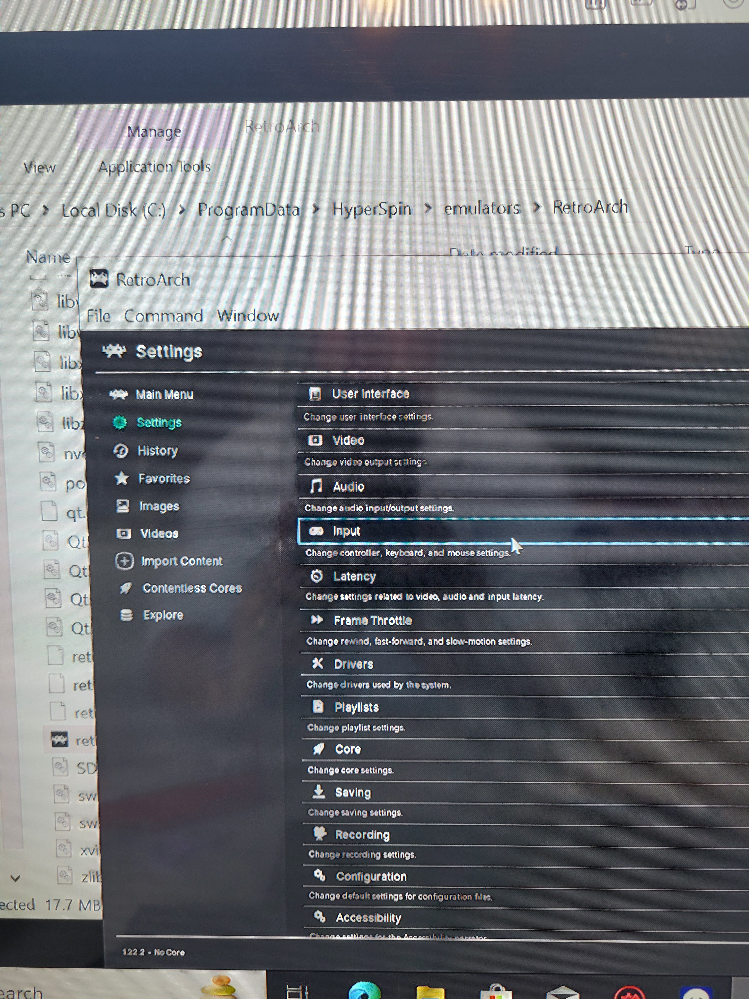

nguerra Posted yesterday at 12:18 AM Author Posted yesterday at 12:18 AM Thank you Thatman84. I found the emulators folder and opened Retroarch directly. From the right side menu, I entered Settings and then input. I dont see a port 1. Perhaps I'm in the wrong spot?

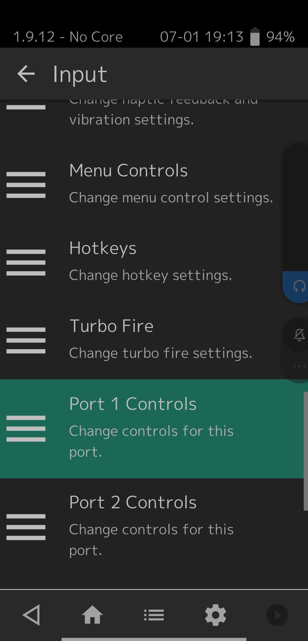

thatman84 Posted 23 hours ago Posted 23 hours ago 18 hours ago, nguerra said: Thank you Thatman84. I found the emulators folder and opened Retroarch directly. From the right side menu, I entered Settings and then input. I dont see a port 1. Perhaps I'm in the wrong spot? Possibly, I won't be at the computer for a few days. Similar layout across all platforms so here is a shot from my android RetroArch. Main Menu Settings -> Input -> Port 1 Controls Hyperspin 2.0 Latest Download Hyperspin 2.0 Documentation -------Pre Hyperspin 2.0 Below---------- HS Android Overview & Install HS Android Base Pack Download My Tutorials

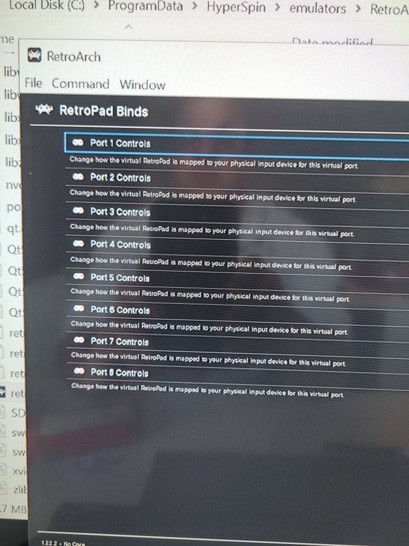

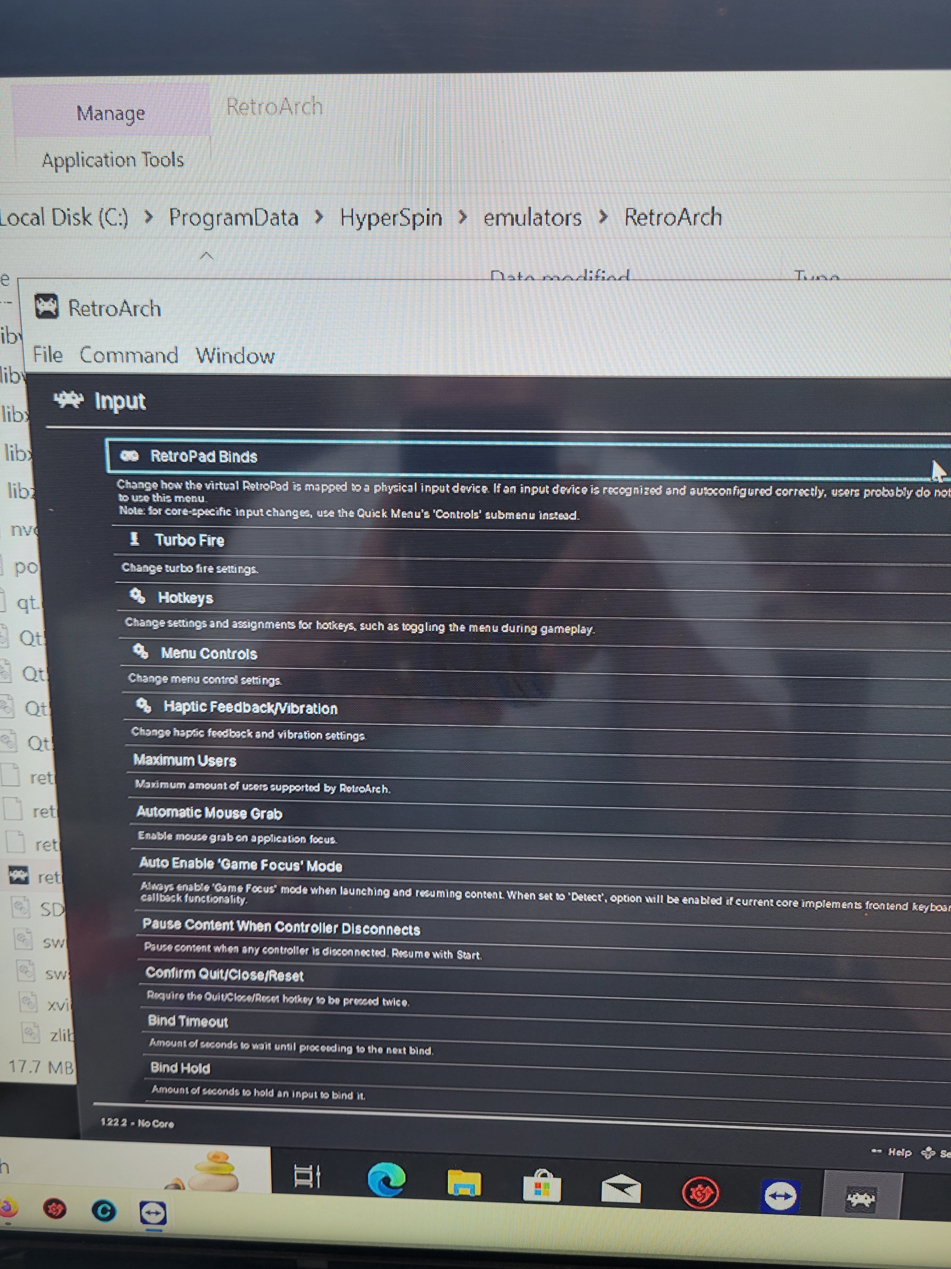

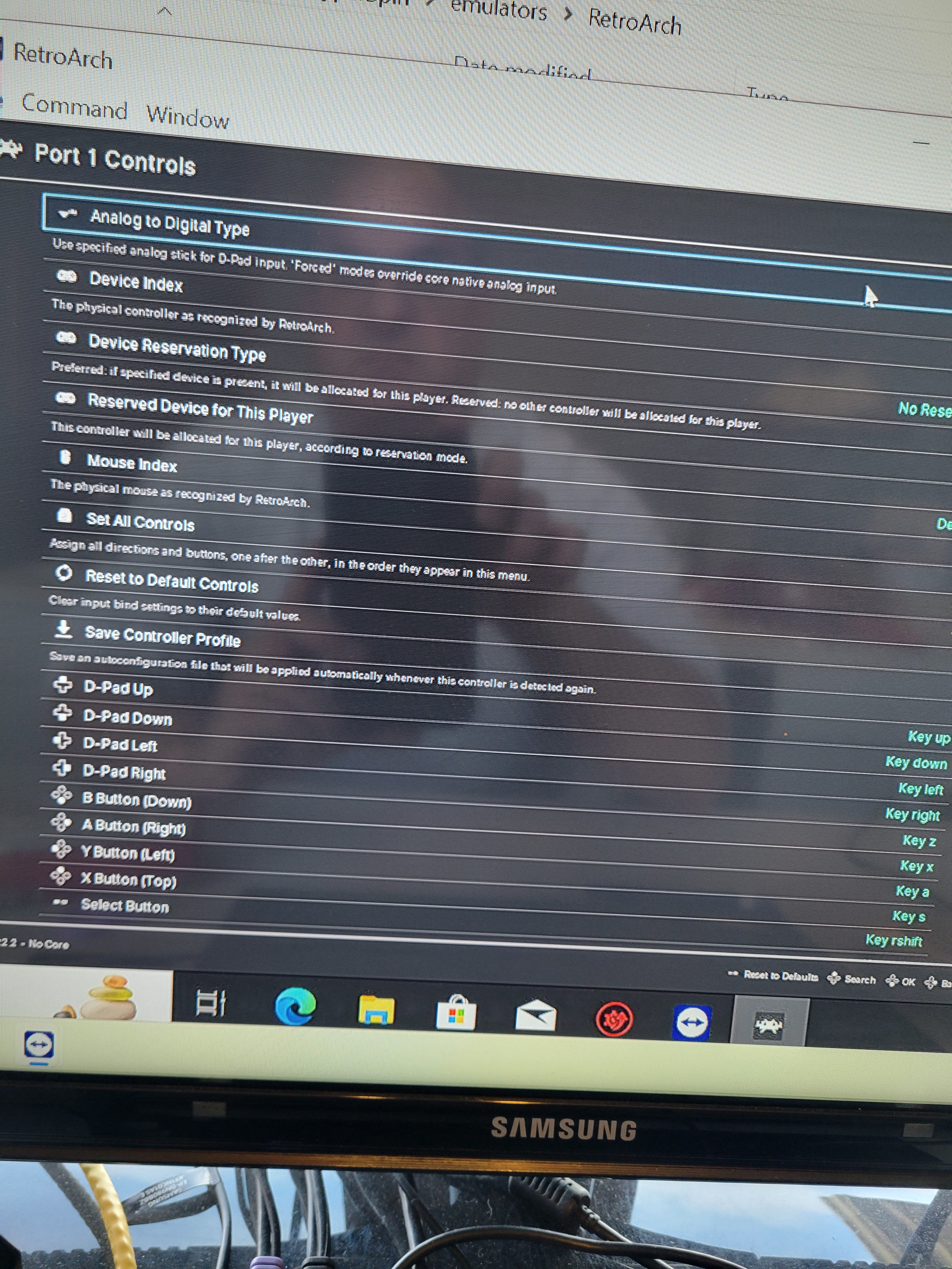

nguerra Posted 22 hours ago Author Posted 22 hours ago OK, I've added some screen shots. I don't have a port 1 controls section. I'm using the retroarch that installed with the hyperspin 2 beta. I don't see any indication of a I-PAC4?
nguerra Posted 22 hours ago Author Posted 22 hours ago The images are out of order. My port 1 controls are behind the retropad binds
thatman84 Posted 19 hours ago Posted 19 hours ago Your in the right spot. ipac is just a keyboard afaik so setup all of your 4player keyboard buttons in the Port1-4 menu (No Core loaded) Retroarch is based on controllers. So you set your buttons which are fixed per player. You then reassign the emulated console button to already fixed keys per player in the Quick Menu -> Controls section Save Remap. Be aware of hotkeys, menu keys and emulated cores that accept keyboard by default (MAMECore, Amiga etc) more info here https://docs.libretro.com/guides/input-and-controls/#keyboard-controls it’s kinda reversed to most emulators where the emulated system controller is fixed and you click to assign the physical button you have. Hyperspin 2.0 Latest Download Hyperspin 2.0 Documentation -------Pre Hyperspin 2.0 Below---------- HS Android Overview & Install HS Android Base Pack Download My Tutorials
nguerra Posted 17 hours ago Author Posted 17 hours ago But doesnt this change everthing globally? How can I change it by core?
thatman84 Posted 11 hours ago Posted 11 hours ago Example not exact buttons:- If Lctrl is retropad A port1 and Retropad B is Z Port 1 Launch Atari game (Stella Core) go into Quick Menu F1 and choose Controls Remap. If Fire is retropad B you change it to Retropad A and save the remap file. You can only swap the configuration of the buttons assigned to Port1 Retropad. Hyperspin 2.0 Latest Download Hyperspin 2.0 Documentation -------Pre Hyperspin 2.0 Below---------- HS Android Overview & Install HS Android Base Pack Download My Tutorials
