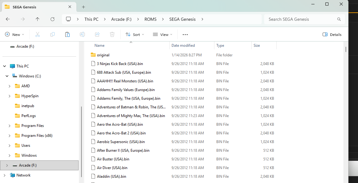

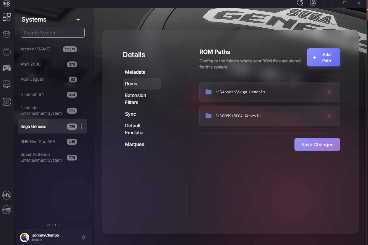

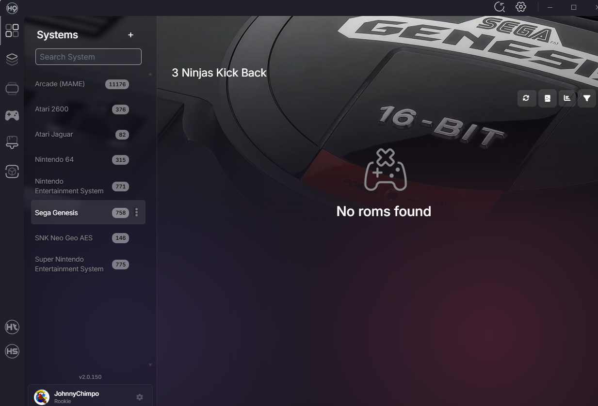

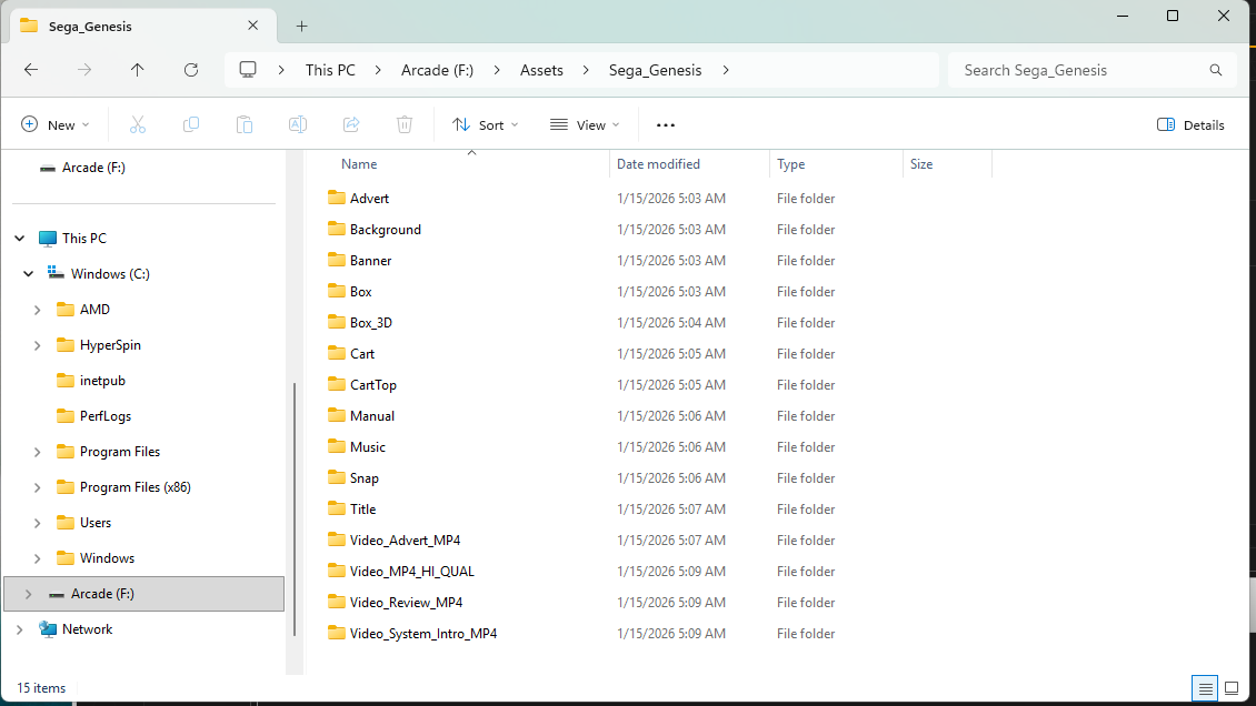

JohnnyChimpo Posted Friday at 05:46 AM Posted Friday at 05:46 AM I have most systems loaded into HQ now, and it's coming along great! For some reason I can't get Sega Genesis to configure correctly. I set it up like the other systems, retroarch as the emulator, but then it scans the rom folders and no games show up. Anyone else have this problem with Sega?

JohnnyChimpo Posted Saturday at 08:35 AM Author Posted Saturday at 08:35 AM I quit and relaunched HQ and Sega and 32X populated all the games. No dreamcast yet but encouraging!
