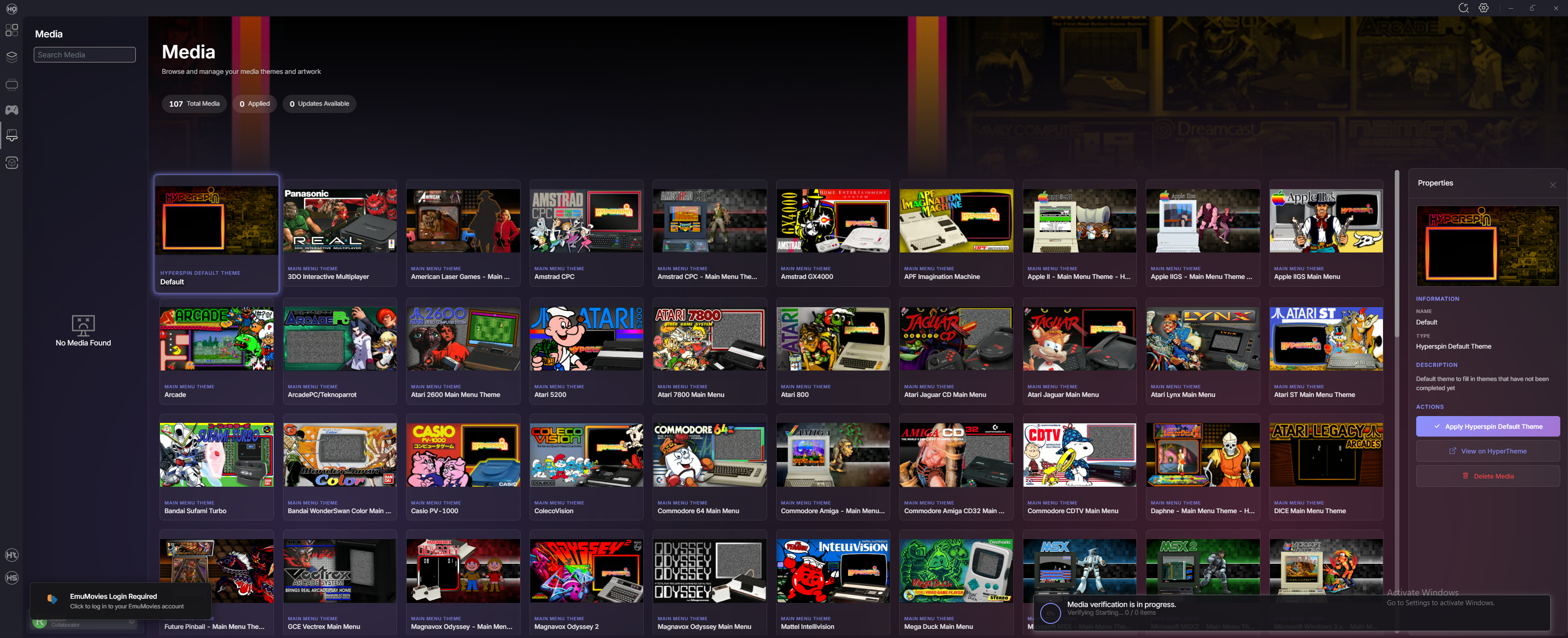

rik81 Posted March 2 Posted March 2 I began messing with this again and this is a recap of what happened. 1. After reinstalling the plugins and doing a media refresh. And after removing a bunch of systems that were added during the mass addition phase of setup. The media assignments started working... so I was like ok... lets jump into hyperspin. 2. Once i get into hyperspin... half of them are freezing on the intial load... wont show the main theme at all. And many also worked. The program didnt freeze... just the scrolling between themes. 3. I started removing the ones that didnt populate the media. And readded the system back. This didnt help and the themes were still frozen upon rechecking. 4. I then deleted the entire media folder and made the program redownload the main media themes. There were a few that were now showing.. like teknoparrot. Most of the other ones still didnt populate. (Even though saying there was a theme assigned under the media tab) Mame is still broken... I gets stuck at 10 percent progress when I add my own rom folder. Nor does it have a main media theme as well. I feel some progress was made... but there are still severe problems.... Im hoping the next update aims to address these things. And im also hoping the devs are actively testing the software. I feel its almost there.... Just need to get over these last hurdles. A couple more issues. 1. Cant delete media on the media tab... If you try and delete it. It says it does... but going to another tab and coming back... the media is still there. 2. Where is the file that holds the cache for the images on the media main menu header? I completely restarted with a fresh version and when I loaded all my old systems were still there. I deleted the entire folder. As well as all the fils that get copied to the C drive in roaming and local. And the images were still there. That tells me there are some artifcats being left behind somewhere. Thanks 1

rik81 Posted March 5 Author Posted March 5 Just to give a little clarity on what I mean... I just ran the reset tool. Clearing out everything and the previews are still here. This is what I was referring to in the orgiianl post. Even if I clear out the hsm folder... and start fresh. Theyre still here. So there has to be something being left behind.... somewhere. 1

rik81 Posted March 5 Author Posted March 5 Actually... im not sure what I did... but I removed the media folder. And everything vanished... I created a new hsm folder and let it redownload. Now I have 53 Total media... and only 3 are applied. I cant apply any of the other media... says its applied after clicking on the button. But clicking another tab, and going back. Its back to 3 applied. UPDATE: I cleared the media cache... and it went to 47 media applied.... Atari Jaguar, Atari Lynx, Atari 800, Bandai Wondersan... wouldnt apply. I applied these manually and it unapplied the all the media back to 3. So maybe its just bad media messing with the cache file? UPDATE2: I removed the systems from the list... and the media themes were still listed in the media tab. However I went in and deleted the media manually... and it also deleted. So thats good. I dont know... ill continue to mess around with things.
