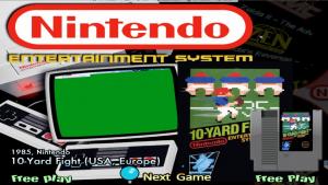

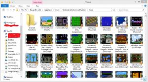

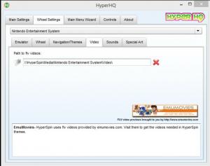

bostnbound Posted September 7, 2014 Posted September 7, 2014 Hi Folks! I'm new to Hyperspin and I'm loving it. I've run into a frustrating issues, though with preview videos. I just singed up for an EmuMovies account, got HyperSync setup and downloaded preview videos for NES. I directed to the correct media folder in HyperHQ but when I boot up Hyperspin, I get the same Green pixelated video screen I did before I had any videos. I did some searching on similar threads. I downloaded the newest K-Lite Codec pack which didn't help anything. THe MP4 videos open fine in VLC or WMP, but just don't seem to render in Hyperspin. Screenshots attached. Any help is appreciated!!
Agrajag Posted September 7, 2014 Posted September 7, 2014 I'm guessing you're using onboard Intel graphics, as there's an issue with this. See the link in my signature for known bugs then follow the link to the thread about how to fix it. HyperSpin behaving oddly? Read about known bugs here: http://www.hyperspin-fe.com/topic/4590-known-bugs-and-handy-hints-for-hyperspin/ The installer for HyperSpin now includes HyperLaunch 2. Go here for support: http://www.hyperspin-fe.com/forum/122-hyperlaunch-2/ HyperLaunch3 is now called RocketLauncher. Go here for support: http://www.rlauncher.com/forum/content.php Read this for ftp login info: http://www.hyperspin-fe.com/topic/2320-ftp-access-must-read/ Platinum members get 25% off an Emumovies subscription: http://www.hyperspin-fe.com/topic/1211-emumovies-code/
