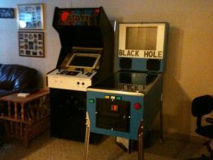

legtod2 Posted April 22, 2012 Author Posted April 22, 2012 Here is the latest updates in my pinball world. My refurbishment project of an original Williams 1978 Phoenix table is gaining momentum. Originally this table was gonna be gutted and used for my virtual pinball project. I replaced the solenoid driver board and 6 solenoids. Founds some shorted and miss wired coils from previous owner. Machine now has three solenoids on right target banks that are not working, but everything else running perfectly. This week i bite the bullet and decided not to use the stencil artwork theme of black hole and hire a top gun decal artist to create a pinball artwork theme for me! My machine still is with out a working nudging solution, which is my biggest disappointment on this project. I am confident sometime soon a tried and true solution will surface. I think my next experiment in this area will be the ms sidewinder mounted in cabinet. Thie machine is without working led buttons. Thinking about using ledblinky but made no progress here. Have a bunch of missing hyperpin media stuff like preview backglasses, wheel images, table previews but sure some of those will surface one day. Missing two full screen tables for my collection Mystic and Phoenix Thats it for now

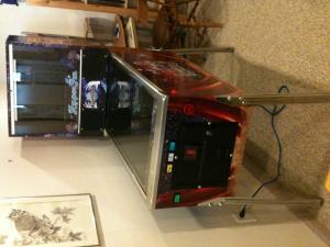

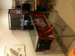

legtod2 Posted May 24, 2012 Author Posted May 24, 2012 Well its picture time again. Let me introduce the machine renamed as Mystic-ball after my favorite machine mystic Here is the machine without artwork Here is machine with new artwork applied
legtod2 Posted May 27, 2012 Author Posted May 27, 2012 Update: I have a working nudging solution finally in my mystic-ball cab. Yahoo, product is actionxl motion controller that has a two buttons and accellerometer. Will be replacing it with an ms sidewinder pro in future but for now it works in both my virtual pinball and future pinball tables. Artwork from lucian045 applied and makes the machine look amazing. Still have to get my illuminated buttons set up and working with my pacled64. Gonna get my coin door operational to accept coins and enable my service buttons on coin door to work (allow volume up/down, etc) Considering getting a compactor for coins and credit awards. Going to add fan to bottom of cabinet to draw air in from front of cab to improve airflow to my 3 rear airflow fans. Going to modify playfield mounting and access to computer hardware. Right now 37 in screen rests on top of four corner posts inside of cabinet walls. Not sure how i'm going to tackel this one yet. Backup and recovery of hard drive plan is 3 folders on the pinball hard drive (copy of hyperpin folder, copy of games folder, copy of virtual pinball folder), these same folders are copied to my home san. In the event of a hard drive failure or pc replacement i would simply reinstall windows xp and sundry of windows updates, vp, hyperpin, futurepinball. Then copy my folders back from the san. Yup still alot of things to do on this project, but kids love it and it gets used frequently!
