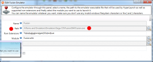

					; Mount the CD using DaemonTools
					If ( scdExtension && dtEnabled = "true" )
						DaemonTools("mount", selectedRom)
				Return
				CloseProcess:
					FadeOutStart()
					WinClose("Fusion ahk_class KegaClass")
					; PostMessage, 0x111, 40039,,,ahk_class KegaClass	; Tells Fusion to Power Off
					; Sleep, 100	; giving time for Fusion to unload rom
					; PostMessage, 0x111, 40005,,,ahk_class KegaClass	; Tells Fusion to exit
				Return
07:47:00:534 | HL |     INFO  | +0     | CheckFile - Checking if W:\Hyperspin\DAEMON Tools Lite\DTLite.exe exists
07:47:00:553 | HL |     INFO  | +31    | BuildScript - Loaded Statistics.ahk script
07:47:00:553 | HL |     INFO  | +0     | BuildScript - Loaded User Functions.ahk script
07:47:00:553 | HL |     INFO  | +0     | BuildScript - Finished injecting functions into module
07:47:00:553 | HL |     INFO  | +0     | Main - Module is built
07:47:00:553 | HL |     INFO  | +0     | CheckFile - Checking if W:\Hyperspin\Hyperlaunch\AutoHotkey.dll exists
07:47:00:571 | HL |     INFO  | +16    | Main - Running module
07:47:00:733 | MD |     INFO  | +N/A   | Module initialized
07:47:00:820 | MD |     INFO  | +94    | StartModule - Started
07:47:00:820 | MD |     INFO  | +0     | StartModule - MEmu: Fusion
				MEmuV: v3.64
				MURL: http://www.eidolons-inn.net/tiki-index.php?page=Kega
				MAuthor: djvj
				MVersion: 2.0.8
				MCRC: 792D6332
				iCRC: 3B62A7B7
				MID:
				MSystem: "Samsung Gam Boy","Sega 32X","Sega CD","Sega Game Gear","Sega Genesis","Sega Master System","Sega Mega Drive","Sega Mega-CD","Sega Pico","Sega SC-3000","Sega SG-1000"
07:47:00:820 | MD |     INFO  | +0     | StartModule - You have a supported System Name for this module: "Sega Genesis"
07:47:00:820 | MD |     INFO  | +0     | StartModule - Ended
07:47:00:821 | MD |     INFO  | +0     | StartGlobalUserFeatures - Starting
07:47:00:821 | MD |     INFO  | +0     | StartGlobalUserFeatures - Ending
07:47:00:821 | MD |     INFO  | +0     | Module - Started reading module ini
07:47:00:821 | MD |     INFO  | +0     | Module Setting - [settings] - Fullscreen: true
07:47:00:821 | MD |     INFO  | +0     | Module Setting - [settings] - ForceFullScreen32: true
07:47:00:821 | MD |     INFO  | +0     | Module Setting - [settings] - hideTitleBar: true
07:47:00:822 | MD |     INFO  | +0     | Module Setting - [settings] - UseRamCarts: true
07:47:00:822 | MD |     INFO  | +0     | Module Setting - [settings] - FluxAudioCD:
07:47:00:822 | MD |     INFO  | +0     | Module Setting - [sega Genesis] - DTWaitTime: 0
07:47:00:822 | MD |     INFO  | +0     | Module Setting - [sega Genesis] - Controller_Reassigning_Enabled: false
07:47:00:823 | MD |     INFO  | +0     | Module Setting - [3 Ninjas Kick Back (USA)] - PerfectSync: false
07:47:00:823 | MD |     INFO  | +0     | Module Setting - [sega Genesis] - MultiTapType: 0
07:47:00:823 | MD |     INFO  | +0     | Module Setting - [3 Ninjas Kick Back (USA)] - MultiTapType: 0
07:47:00:823 | MD |     INFO  | +0     | Module Setting - [sega Genesis] - Genesis_P1_Controller: 2
07:47:00:823 | MD |     INFO  | +0     | Module Setting - [3 Ninjas Kick Back (USA)] - Genesis_P1_Controller: 2
07:47:00:824 | MD |     INFO  | +0     | Module Setting - [sega Genesis] - Genesis_P1b_Controller: 2
07:47:00:824 | MD |     INFO  | +0     | Module Setting - [3 Ninjas Kick Back (USA)] - Genesis_P1b_Controller: 2
07:47:00:824 | MD |     INFO  | +0     | Module Setting - [sega Genesis] - Genesis_P1c_Controller: 2
07:47:00:824 | MD |     INFO  | +0     | Module Setting - [3 Ninjas Kick Back (USA)] - Genesis_P1c_Controller: 2
07:47:00:824 | MD |     INFO  | +0     | Module Setting - [sega Genesis] - Genesis_P1d_Controller: 2
07:47:00:825 | MD |     INFO  | +0     | Module Setting - [3 Ninjas Kick Back (USA)] - Genesis_P1d_Controller: 2
07:47:00:825 | MD |     INFO  | +0     | Module Setting - [sega Genesis] - Genesis_P2_Controller: 2
07:47:00:825 | MD |     INFO  | +0     | Module Setting - [3 Ninjas Kick Back (USA)] - Genesis_P2_Controller: 2
07:47:00:825 | MD |     INFO  | +0     | Module Setting - [sega Genesis] - Genesis_P2b_Controller: 2
07:47:00:825 | MD |     INFO  | +0     | Module Setting - [3 Ninjas Kick Back (USA)] - Genesis_P2b_Controller: 2
07:47:00:826 | MD |     INFO  | +0     | Module Setting - [sega Genesis] - Genesis_P2c_Controller: 2
07:47:00:826 | MD |     INFO  | +0     | Module Setting - [3 Ninjas Kick Back (USA)] - Genesis_P2c_Controller: 2
07:47:00:826 | MD |     INFO  | +0     | Module Setting - [sega Genesis] - Genesis_P2d_Controller: 2
07:47:00:826 | MD |     INFO  | +0     | Module Setting - [3 Ninjas Kick Back (USA)] - Genesis_P2d_Controller: 2
07:47:00:827 | MD |     INFO  | +0     | Module Setting - [sega Genesis] - SMS_P1_Controller: 1
07:47:00:827 | MD |     INFO  | +0     | Module Setting - [3 Ninjas Kick Back (USA)] - SMS_P1_Controller: 1
07:47:00:827 | MD |     INFO  | +0     | Module Setting - [sega Genesis] - SMS_P2_Controller: 1
07:47:00:827 | MD |     INFO  | +0     | Module Setting - [3 Ninjas Kick Back (USA)] - SMS_P2_Controller: 1
07:47:00:827 | MD |     INFO  | +0     | Module Setting - [sega Genesis] - Genesis_P1_Use: 1
07:47:00:828 | MD |     INFO  | +0     | Module Setting - [3 Ninjas Kick Back (USA)] - Genesis_P1_Use: 1
07:47:00:828 | MD |     INFO  | +0     | Module Setting - [sega Genesis] - Genesis_P1b_Use: 1
07:47:00:828 | MD |     INFO  | +0     | Module Setting - [3 Ninjas Kick Back (USA)] - Genesis_P1b_Use: 1
07:47:00:828 | MD |     INFO  | +0     | Module Setting - [sega Genesis] - Genesis_P1c_Use: 1
07:47:00:829 | MD |     INFO  | +0     | Module Setting - [3 Ninjas Kick Back (USA)] - Genesis_P1c_Use: 1
07:47:00:829 | MD |     INFO  | +0     | Module Setting - [sega Genesis] - Genesis_P1d_Use: 1
07:47:00:829 | MD |     INFO  | +0     | Module Setting - [3 Ninjas Kick Back (USA)] - Genesis_P1d_Use: 1
07:47:00:829 | MD |     INFO  | +0     | Module Setting - [sega Genesis] - Genesis_P2_Use: 1
07:47:00:829 | MD |     INFO  | +0     | Module Setting - [3 Ninjas Kick Back (USA)] - Genesis_P2_Use: 1
07:47:00:830 | MD |     INFO  | +0     | Module Setting - [sega Genesis] - Genesis_P2b_Use: 1
07:47:00:830 | MD |     INFO  | +0     | Module Setting - [3 Ninjas Kick Back (USA)] - Genesis_P2b_Use: 1
07:47:00:830 | MD |     INFO  | +0     | Module Setting - [sega Genesis] - Genesis_P2c_Use: 1
07:47:00:830 | MD |     INFO  | +0     | Module Setting - [3 Ninjas Kick Back (USA)] - Genesis_P2c_Use: 1
07:47:00:830 | MD |     INFO  | +0     | Module Setting - [sega Genesis] - Genesis_P2d_Use: 1
07:47:00:831 | MD |     INFO  | +0     | Module Setting - [3 Ninjas Kick Back (USA)] - Genesis_P2d_Use: 1
07:47:00:831 | MD |     INFO  | +0     | Module Setting - [sega Genesis] - SMS_P1_Use: 1
07:47:00:831 | MD |     INFO  | +0     | Module Setting - [3 Ninjas Kick Back (USA)] - SMS_P1_Use: 1
07:47:00:831 | MD |     INFO  | +0     | Module Setting - [sega Genesis] - SMS_P2_Use: 1
07:47:00:831 | MD |     INFO  | +0     | Module Setting - [3 Ninjas Kick Back (USA)] - SMS_P2_Use: 1
07:47:00:832 | MD |     INFO  | +0     | Module - Finished reading module ini
07:47:00:832 | MD |     INFO  | +0     | CheckFile - Checking if W:\Hyperspin\Emulators\sega master system\fusion.ini exists
07:47:00:835 | MD |     INFO  | +15    | Run - Running: W:\Hyperspin\Emulators\sega master system\Fusion.ini -auto -gen -fullscreen "W:\Hyperspin\Emulators\Sega Genesis\Roms\3 Ninjas Kick Back (USA).md"
07:47:00:978 | MD |     INFO  | +141   | WinWait - Waiting for "Fusion ahk_class KegaClass"
07:47:33:945 | MD |    ERROR  | +32963 | There was an error waiting for the window "Fusion ahk_class KegaClass". Please check you have the correct version emulator installed for this module, followed any notes in the module, and have this emulator working outside your Frontend first. Also turn off Fade to see if you are hiding your problem.
07:47:33:945 | MD |     INFO  | +0     | ExitModule - Started
07:47:33:945 | MD |     INFO  | +0     | Starting Updating Statistics:
07:47:33:945 | MD |     INFO  | +0     | CreateRomTable - Started
07:47:33:945 | MD |     INFO  | +0     | CreateRomTable - Ended, 7 Loops to create table.
07:47:34:076 | MD |     INFO  | +124   | Game section statistics updated.
07:47:34:077 | MD |     INFO  | +0     | ExitModule - Ended
07:47:34:077 | MD |     INFO  | +0     | End of Module Logs
07:47:34:179 | HL |     INFO  | +33603 | Main - Module ended, exiting HyperLaunch normally
07:47:34:179 | HL |     INFO  | +0     | ExitScript - Started
07:47:34:226 | HL |     INFO  | +46    | SystemCursor - Restoring mouse cursor
07:47:34:244 | HL |     INFO  | +16    | ExitScript - Ended
You are The Boss, I dont know how I missed that, but you are totally right, T H A N K you, I changed it and it s working.
(by the way, I have been browsing the forum for over a year now, each time i was able to find the solution on my own or with other thread from the forum).
Thanks Hyperpsin users.
