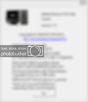

craiganderson Posted September 24, 2014 Author Posted September 24, 2014 which emulator are u running? here is what i am using and it is working great i dont remember where i got it....but i can share a link if u need it here is the link on the pic http://www.geocities.jp/kugimoto0715/ but its weird http://craigandersonthemes.weebly.com/
