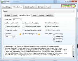

gigapig Posted October 2, 2014 Posted October 2, 2014 Hey Paul Michel. MP4 is not support for the front end video, it has to be .flv. Your other issue, make sure "Reload backgrounds" is checked for each system.
paulmichel21 Posted October 2, 2014 Author Posted October 2, 2014 Hi gigapig in hyperspin update release date its for only wheels? v1.3 Added mp4 support Added wheel smoothing for crisper wheel graphics and text. Updated flash player to 11. Added last system support when restarting HyperSpin. Tried to fix sound issue (untested) Added PCLauncher support for HyperLaunch. Hey Paul Michel.MP4 is not support for the front end video, it has to be .flv. Your other issue, make sure "Reload backgrounds" is checked for each system. [ATTACH=CONFIG]45348[/ATTACH] i checking "Reload backgrounds" thanks.....
