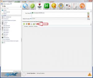

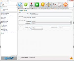

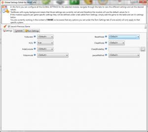

albert_c Posted October 15, 2014 Posted October 15, 2014 I don't think that is it. Those settings are the bezel settings for HyperLaunch. HyperLaunch having its own bezel functionality which works with the all the emulators it supports. You want to disable those HyperLaunch bezel settings for MAME system settings so you can use the MAME bezels. I think this is where you are: These settings would enable HyperLaunch's bezels and isn't what you want. Where you should be is here to enable the MAME settings: That screen is found in HyperLaunchHQ>MAME>Emulators Tab>Edit Global Module Settings. Screenshot of that button is below: Let me know how it goes because I am downloading the MAME extras as we speak. When you find great deals on Craigslist for CRT based cabs, exuberance can be a bad thing! Current status of cabs: 0/5 working as desired :wallbash:
redturbomr2 Posted October 15, 2014 Author Posted October 15, 2014 I don't think that is it. Those settings are the bezel settings for HyperLaunch. HyperLaunch having its own bezel functionality which works with the all the emulators it supports. You want to disable those HyperLaunch bezel settings for MAME system settings so you can use the MAME bezels.QUOTE]Thanks for the reply. I just tried that, and enable all the bezels, but it still doesn't work, I even seen a place where you can add a rom and edit some features but that still doesn't work. I'm thinking that I don't have the bezels in the correct folder or something, or there's a spot that I don't see where I can select the bezel folder. I'm off to work, i'll mess around with it some more tonight.

boohiss Posted October 16, 2014 Posted October 16, 2014 In HyperLaunchHQ: MAME from the list on the left, then Emulators tab on top. Click "Edit Global Module Settings" button near middle of window. Click the MAME tab, and in the "Params" box type: -use_bezels As I said I had tried enabling bezels everywhere else without success, and the above did the trick for me finally. There may be another solution but hey it worked .
