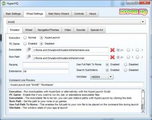

Make sure everything is correct here, paths and extension, if your using wheel filters.
