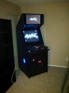

[email protected] Posted November 30, 2014 Posted November 30, 2014 well i got this cabinet built by this guy he came to my house and he built it.. it was working find when u play one player but when u play 2players it keeps beeping and freezing and beeping making it impossible to play , i called the guy that built this for me but he said he has no idea what to do , now he won't even answer calls.. i have a arcade guy that said my problem is my ram , and another guy saying it is my processor,, but both of them guys never had a cabinet with hyper spin , so if there is some one out there with a solution please guide me ,,,

eezetee Posted December 1, 2014 Posted December 1, 2014 Do the games work in MAME? THat's a pretty good starting point? I may have missed it, but what is the control board? IPAC? Any pictures?

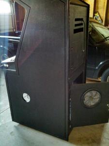

Gothicplsur Posted December 4, 2014 Posted December 4, 2014 Do you have an adequate air flow, sounds like a heat issue, if your motherboard is making the beeps and freezing, either your cpu is working overtime when you add a second player or your ram is insufficient but airflow is a major factor. In my standup arcade I have 2 120mm fans on each side of the cab and a 200mm "exhaust" fan on the back and it's nice and chilly inside... probably should start there with heat/fan issues.
