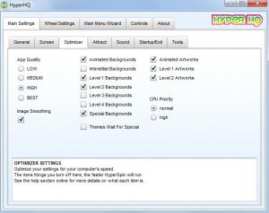

Silverback Posted December 4, 2014 Posted December 4, 2014 Look at your optimizer options in HyperHQ Here you will be able to adjust the amount of transitions and level of quality.
eezetee Posted December 4, 2014 Author Posted December 4, 2014 Hi Silverback, are those transitions the "stock" hyperspin ones or will it affect the themes that i've put in the folders?
Silverback Posted December 4, 2014 Posted December 4, 2014 It will relate to any transitions i believe. It changes how 'fancy' you want your system to look which puts more of a load onto the system. Try to untick some and to a trial and error to see what works best.
eezetee Posted December 5, 2014 Author Posted December 5, 2014 Thanks Silverback69. I removed the Level 1 and 2 Backgrounds and although the themes don't load as smoothly (there is a distinct transition) there is a lot less explosuion, falling start and other "stuff" on the screen which was a bit much. Cheers!
