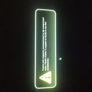

Goomba88 Posted December 6, 2014 Posted December 6, 2014 Hey guys I'm having another problem with my hyperspin program. All my roms are zipped and they work fine on all my emulators. For most of my Sega systems im using the Fusion emulator. fusion plays all my sega Genesis and game gear roms perfectly as zipped files. But when I try to play my master system roms this erros comes up (will add picture as attatchment) can someone tell me what I need to do?? Thanks!!
rfancella Posted December 6, 2014 Posted December 6, 2014 Hey guys I'm having another problem with my hyperspin program. All my roms are zipped and they work fine on all my emulators. For most of my Sega systems im using the Fusion emulator. fusion plays all my sega Genesis and game gear roms perfectly as zipped files. But when I try to play my master system roms this erros comes up (will add picture as attatchment) can someone tell me what I need to do?? Thanks!! Hi, Try unzipping one rom. Make sure the name is correct in the un-zipped rom. Move or rename the zipped rom and try to launch the un-zipped rom. Also, as per this post. Please post your HyperLaunch log, set to Troubleshooting. http://www.hyperspin-fe.com/forum/showthread.php?31072-The-HyperNoobie-Guide-For-Posting-To-The-Fourm And don't forget to use code tags. Thanks, Ron Code Monkey and all around Command Line geek!If you like what someone has said or done for you, be sure and 'Thank' them. And if they changed your life, send them a Beer!
rexryan Posted December 6, 2014 Posted December 6, 2014 is the emulator set up to support 7z files? 7z|zip|sg|gg|sms|gen|32x|md|cue|bin|iso mine work fine..
