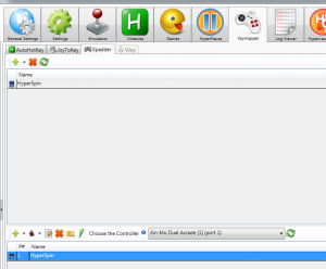

What I have to do to make it working is start Hyper Launch, go to GLOBAL then Keymapper tab and click on HyperSpin to reveal HyperSpin profile in the subpanel above.
Once I do this I can run HyperSpin and my arcade controls work.

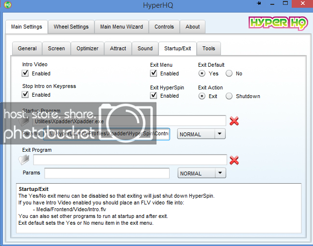

I setup Hyperspin to launch Xpadder with the appropiate profile during the startup of the frontend. You can do that in HyperHQ, on main setting, in the tab "Startup/Exit" Add XPadder to the Startup Program (Utilities\Xpadder\Xpadder.exe) and the Xppader profile you use with the frontend in Params ("..\..\HyperLaunch\Profiles\Xpadder\HyperSpin\Controller (Xbox 360 Wireless Receiver for Windows)\p1.xpadderprofile"). Good thing about this is you can use relative paths for maximum portability.
