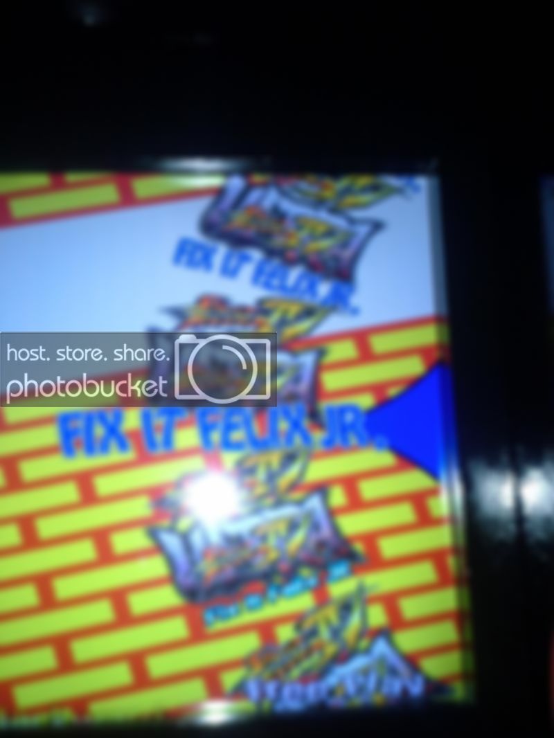

Frogger Posted January 28, 2015 Posted January 28, 2015 Hi I'm runing a PC tab in hyperspin, it only has 3 games Street Fighter - Street Fighter Ultra and Fix it Felix The problem I am havng is the wheel art for Fix it Felix dissapears as you scroll through the wheel. At the beling the logo is there but as you scroll through a few time that particular logo dosent appear anymore. You can see in the pic the logo is there in the first 2 slots but the trid is the default generated font and if you keep scrolling it will evently all be like the default font type It's only happening for this game and this tab only, got me stumped any help?
therealdealadam Posted January 28, 2015 Posted January 28, 2015 Its just named incorrectly, rename it something else, save that then rename it (",)
rfancella Posted January 28, 2015 Posted January 28, 2015 Adam is correct. Because it is showing sometimes, usually that means it's not case correct. Make sure it's exactly the same. Example: If your database shows it as Fix It Felix, be sure your wheel image is the same and not Fix it Felix. Or vice versa. With HyperSpin, case is sensitive. Thanks, Ron Code Monkey and all around Command Line geek!If you like what someone has said or done for you, be sure and 'Thank' them. And if they changed your life, send them a Beer!
THK Posted January 28, 2015 Posted January 28, 2015 make sure: correct case sensitive name file<>xml lower case extension for all wheels, so .png not .PNG no syntax errors in the xml ..........................back with a vengeance........................
