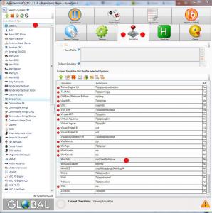

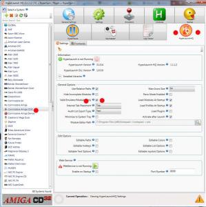

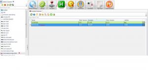

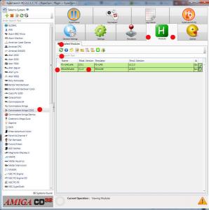

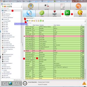

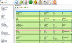

gigapig Posted January 31, 2015 Posted January 31, 2015 Does the module appear in this list under global? And this? If not click the green arrows to refresh. Same here, if not refresh. If none of that works you can uncheck the valid emulators/modules only to bring up the full list. If a module does not show up to select, it's usually down to a spelling mistake or a case mistake.

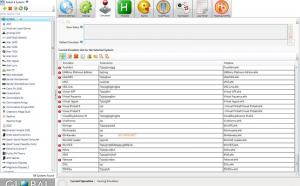

microbytemob Posted January 31, 2015 Author Posted January 31, 2015 This is what i have m8 once again thousand thx for your help!!THE MODULE DOES NOT appear in the list under global thx

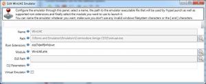

gigapig Posted January 31, 2015 Posted January 31, 2015 It's may be missing from the Global Emulators.ini You could add a new one. From your first screen shot above, click the green + button and then fill out the details as below except the emulator path.
microbytemob Posted January 31, 2015 Author Posted January 31, 2015 superb many thx something so simple as adding it to global emulators ini lol many thx also on your great tut videos on youtube helped me big time setting up taito x & pinball fx 2
