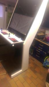

optical Posted February 2, 2015 Posted February 2, 2015 Hey Folks !! i m very happy to show you my arcade machine, that i m build! now i m just finish with the electronic. but i have there al little problem. i hope someone can help me. when a friend and me are playing a two player game we first set die bottom config in each emulator. but for some reason when player two press some buttoms it has actions for player 1. and otherwiese. i m very sure i did the cableing on the ipac good. i m thinking maybe its because i did a own daisy chain for player one and player two. ""player one has is own diasy chain, and player two has its own daisy chain"". i m sorry for my bad engl. but in my country theres not such szene like in US. thank u for helping !!
HazzardActual Posted February 2, 2015 Posted February 2, 2015 Good looking machine! Sounds like the problem your having might be solved by going into each emulator and checking to make sure theres not duplicate buttons for p1 & p2

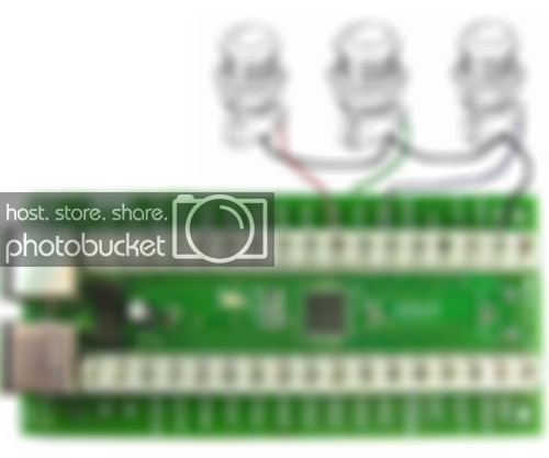

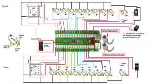

sucramjd Posted February 2, 2015 Posted February 2, 2015 no i dont use this software. du u have a link for me?so u daisy chained everything and put that in the ipac by player 1 ground? i daisy chained everthing from player 1 and put that in ipac player 1 ground. and then i daisy chained everthing from player two and put that in player two ground in the ipac Your only supposed to daisy chain the ground wires i think, just google ultimarc then you'll be in the right place, they have all the wiring diagrams on there, not sure if i can direct link here or not. Nice looking cab btw [sIGPIC][/sIGPIC]
sucramjd Posted February 2, 2015 Posted February 2, 2015 yeah just daisychain the ground like the picture thats for one player do the other side for 2 players [sIGPIC][/sIGPIC]
optical Posted February 2, 2015 Author Posted February 2, 2015 Thank you very mutch Do you mean the prog "winipac v2" ? I found some diagrams. and when i m looking right i make it just like on the pic. all bottoms from player 1 daisy chain in player 1 ground (ipac). and the same for player two. i just see that the ipac has his own plug in for a other (real) keyboard. i have my real keyboard plug in the computer by a usb port. maybe thats the prob?
sucramjd Posted February 2, 2015 Posted February 2, 2015 i'm not sure mines a minipac that only connects via usb, but if you've wired it like the picture that is correct.yes winipac v2 that must be new wasnt called that before and looks very different to what i used but should do the same thing, lets you assign all the buttons and sticks. [sIGPIC][/sIGPIC]

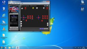

optical Posted February 2, 2015 Author Posted February 2, 2015 done! so most of the bottoms are working fine.. by 2 bottoms windows makes "bing bing" noice. some bottoms are like the "tab" bottom ore "alt". is there a programm witch i can config the ipac? like when i press the arcade stick "up" that should be the "L" on the keyboard.. ore dont i need this? ahhhhh i m so sorry to be sutch a noob
sucramjd Posted February 2, 2015 Posted February 2, 2015 done!so most of the bottoms are working fine.. by 2 bottoms windows makes "bing bing" noice. some bottoms are like the "tab" bottom ore "alt". is there a programm witch i can config the ipac? like when i press the arcade stick "up" that should be the "L" on the keyboard.. ore dont i need this? ahhhhh i m so sorry to be sutch a noob http://www.ultimarc.com/download_old.html this is the program you need i think well its the one i used, winipac v2 is for boards from 2015. [sIGPIC][/sIGPIC]
optical Posted February 2, 2015 Author Posted February 2, 2015 thank u very mutch. but this will not have any consequences for my real keyboard i use?
sucramjd Posted February 2, 2015 Posted February 2, 2015 thank u very mutch. but this will not have any consequences for my real keyboard i use? no it just remapps your ipac to what ever you want, i remeber now when i set mine up over two years ago one of the button presses minimised the screen so i changed all my keys i have player 1, 1 start, 5 coin, up up arrow, down down arrow, left left arrow, right right arrow, button 1-6 abcdef player 2 was up g, down h, left i, right j, button 1-6 klmnoq so you can basicaly change them to whatever you want. [sIGPIC][/sIGPIC]
optical Posted February 2, 2015 Author Posted February 2, 2015 i think i found the Problem with this Programm. i thinking the bottoms L.Alt, L.Ctrl and L.Shift are making Trouble.. now i dont find out where ore how i Chose to Change the bottoms. example: "L.Alt" should Change to "P" can u explain to me how to program the bottoms? and the bottoms wheres Standing n/a, they are connected to the ipac but i cant Chose them.. any idea?
sucramjd Posted February 2, 2015 Posted February 2, 2015 i think i found the Problem with this Programm. i thinking the bottoms L.Alt, L.Ctrl and L.Shift are making Trouble..now i dont find out where ore how i Chose to Change the bottoms. example: "L.Alt" should Change to "P" can u explain to me how to program the bottoms? and the bottoms wheres Standing n/a, they are connected to the ipac but i cant Chose them.. any idea? I havn't used this program in a long time think you need to press the program button bottom right then when you've changed them hit the save button like i said its been a long time, i'll look into it for you tomorrow i'll have a look on my cab. [sIGPIC][/sIGPIC]
sucramjd Posted February 3, 2015 Posted February 3, 2015 ok. thank you. see u tomorrowhave you looked here?http://www.ultimarc.com/winipac_ipd.html Basicaly you design you panel layout then save it, then you can program your buttons, try to translate the page to your native language might make more sense than my english. But if you have no luck i will have a look into it tomorrow evening [sIGPIC][/sIGPIC]
optical Posted February 3, 2015 Author Posted February 3, 2015 right now i m uploading a video, that u can see my problem better. 10 min it should be online in winipac i allready diseabled all shift keys.
