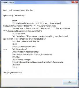

jimmyuk86 Posted February 15, 2015 Posted February 15, 2015 Set this system up and was working fine before i made a backup copy of hyperspin to another hard drive. My antivirus was detecting false viruses and trying to mess with the taito folder. Now when i try to open any taito type x game on both my main and backup drive im getting this error... can anyone help?
jimmyuk86 Posted February 17, 2015 Author Posted February 17, 2015 ok..so i upgraded through tortoisegit. Have set hyperspin as my frontend and all systems have re-appeared on the left hand side but when i try to launch any system now, im getting this...
gigapig Posted February 17, 2015 Posted February 17, 2015 Go into the Module extensions folder, you need to copy the dxwnd (Example).ini paste it and rename it to dxwnd.ini
jimmyuk86 Posted February 18, 2015 Author Posted February 18, 2015 gigapig said: Go into the Module extensions folder, you need to copy the dxwnd (Example).ini paste it and rename it to dxwnd.ini Thanks gigapig!
