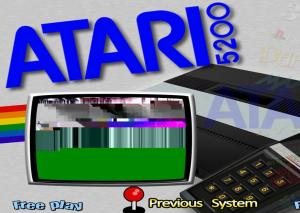

relic Posted February 16, 2015 Posted February 16, 2015 ok i have an nvidia gefore video card and im getting that fuzzy effect in hyperspin yes i have updated to the latest one 100%
xagesz Posted February 16, 2015 Posted February 16, 2015 do you have the hd4000 intel cpu? ON my machine I have a dedicated GPU and the hd4000. When Hyperspin was starting it was using the HD4000 chipset giving me this issue. Had to change a setting to force it on the gpu "Pinball Unknown" - 46/30/DMD - A work in Progress Kick it Harder
relic Posted February 17, 2015 Author Posted February 17, 2015 https://support.serato.com/hc/en-us/articles/202305784-Changing-graphics-card-settings-to-use-your-dedicated-GPU-on-a-Windows-computer- 100%
relic Posted February 17, 2015 Author Posted February 17, 2015 solved the problem with that guide 100%
