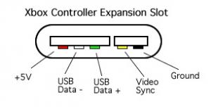

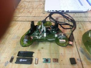

helltick1 Posted February 22, 2015 Posted February 22, 2015 Hi Guys, Just wanted to say thanks for the front end. I use it exclusively for Mame and have had a blast setting everything up. I lurked around for a portable solution of HS. I found you can have relative paths to usb flash drives. I love the original Xbox controller layout, and the fact that it's a usb hub with a controller attached. I installed a 6' usb cable and 8GB internal flash memory. I found this to be the most portable solution since it will work on any windows laptop/desktop. Once plugged in shows up as mass storage, just like a thumb drive. To activate the controller just install the one click driver installer (XBCD). http://www.redcl0ud.com/xbcd.html#download Nothing is installed to host PC except the controller driver. Works on any windows machine I throw at it. Here is a pic of the old "big duke". Just use these diagrams. In settings, set MAME to: [exe info] path=..\HyperSpin\Emulators\Mame\ rompath=..\HyperSpin\Emulators\Mame\roms\ userompath = false exe=mame.exe romextension = zip parameters = searchsubfolders = false pcgame = false winstate = HIDDEN hyperlaunch=true Love this shit...portable controller with everything built in. Games/Themes/Videos/Wheel Art/Settings/button mapping...All setup, every time you plug the controller in. Robotron with two thumbsticks kicks ass. At any rate, just thought I'd share. I use to modify Xbox consoles and have a shit ton of these controllers. Very simple to do. Thank You very much for the front end. Cheers!
HazzardActual Posted February 22, 2015 Posted February 22, 2015 cool idea dude, care to show a video of it in action? Did you wire that usb stick in parallel?

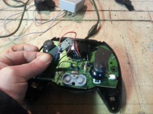

helltick1 Posted February 23, 2015 Author Posted February 23, 2015 I have a SNES controller I did the same thing with. Yeah, it ain't rocket science...I needed two thumbsticks for Robotron. Xbox controller is a USB hub...I connected a flash drive (internally). Here is a phone vid of the controller plugged in to a win7 laptop. Works great!
