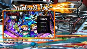

jimmyuk86 Posted February 26, 2015 Posted February 26, 2015 So..i go to start up pinball fx2 through hyperspin after adding some new tables and before i can load a table i get a multiplayer menu come up... is there any way of bypassing or removing it?
jimmyuk86 Posted February 26, 2015 Author Posted February 26, 2015 thanks changed pinball fx2 ahk... multiplayerMenu := IniReadCheck(settingsFile, "Settings", "Multiplayer_Menu","true",,1) to... multiplayerMenu := IniReadCheck(settingsFile, "Settings", "Multiplayer_Menu","false",,1) and loads up now without that annoying menu!
