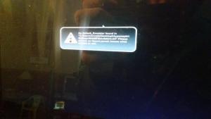

nesgoomba Posted March 2, 2015 Posted March 2, 2015 Getting an error everytime i try to load something in MAME through Hyperspin, coming up as "No Defualt_Emulator error. Dunno if im just missing a file or what, but its becoming a HUGE headache for me. I have all other Cart based systems working, with video, wheel, etc. Mame theme, wheel, video, etc all work. Just doenst load the game. Please help, thanks
DrMaxwell Posted March 6, 2015 Posted March 6, 2015 You haven't set the emulator up properly. Your default emulator for MAME isn't pointed at any exe. How to guides and custom artwork sets @ https://www.youtube.com/user/MaxwellParadigm Themes, Wheels, Carts and Database Downloads available @ http://spacevalkyrie.weebly.com/
scooter1974 Posted March 6, 2015 Posted March 6, 2015 In HyperLaunch HQ, click MAME in your system list and then click the emulator tab, next to the settings tab. Then click the magnifying glass icon next to Default Emulator and select your default emulator. If you haven't done so yet, also set up your rom and emulator paths as well Check out my MAME Arcade classics themes!
