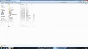

YOOLEE Posted March 8, 2015 Author Posted March 8, 2015 This setup is about a week old I have most of the systems running ok but I did update it so I guess i may have something wrong . I have posted pic below of my folders .Also where does the HyperLaunch Log populate so I can post it. Thanks Main Hyperspin folder

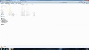

YOOLEE Posted March 8, 2015 Author Posted March 8, 2015 Inside of the hyperlaunch folder hyperlauch seems to load it but not in the main forlder or hyperspin wheel. Is it setup wrong I started from the begining and updated it .
gigapig Posted March 8, 2015 Posted March 8, 2015 Forget the one in the main HyperSpin folder. The log can be found in the HyperLaunch folder, it's called HyperLaunch.log You can set the logging level in HLHQ.

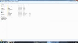

YOOLEE Posted March 8, 2015 Author Posted March 8, 2015 the only Hyperlaunch tkt file or file called hyperlaunch that i was able to find in hyperlaunch folder is below

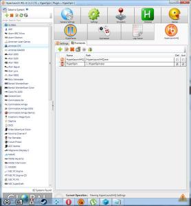

gigapig Posted March 8, 2015 Posted March 8, 2015 From the log it looks like the front end being used is HyperLaunch HQ, not HyperSpin. You will need to change that in HLHQ.
YOOLEE Posted March 8, 2015 Author Posted March 8, 2015 I checked my settings and the options are set to Hyperspin like you have in the picture above . I don't understanding why the hyperlaunch in the hyperlaunch folder runs it ok but hyperlaunch(green H) in the main folder give me the black screen.

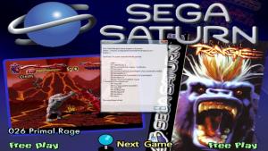

YOOLEE Posted March 9, 2015 Author Posted March 9, 2015 I deleted the old one and when I tried to run a game in hyperspin I get cannot find hyperlaunch.exe so i put it back . Hyperlaunch in the main folder seems to be controlling hyperspin not the one in the Hyperlauch folder and that one works I noticed an error when I pressed esc from the black screen but it closes out really quick its in the image below.
gigapig Posted March 9, 2015 Posted March 9, 2015 You don't necessarily need to remove it, but you need to change the path so HyperSpin is using the other one in the folder. To do that navigate to the hyperspin\settings folder. Open the settings.ini file and change the path to HyperLaunch.
YOOLEE Posted March 9, 2015 Author Posted March 9, 2015 Sir gigapig..... That fixed my problem it was the path in the settings .ini....thank for all your help its loading great now .
