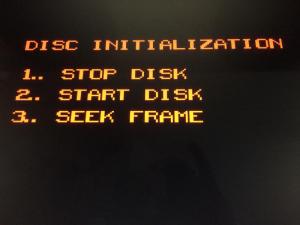

mastermark Posted March 8, 2015 Posted March 8, 2015 Hi guys just got mach3 added to my hard drive, works perfect when i run it using the Loader. When i then run it through HS i get this.......... Any Help i would be thankful
rfancella Posted March 8, 2015 Posted March 8, 2015 mastermark said: Hi guys just got mach3 added to my hard drive, works perfect when i run it using the Loader.When i then run it through HS i get this.......... ...snip... Any Help i would be thankful Hi, Please post your daphne_log.txt files found in the emulator folder. Launch the game from the loader and post it. Then launch the same game from HS and post that log also. I'm sure there will be some differences. Thanks, Ron PS: Please post all log files wrapped in code tags. To find out how, please read this post: http://www.hyperspin-fe.com/forum/showthread.php?31072-The-HyperNoobie-Guide-For-Posting-To-The-Fourm Code Monkey and all around Command Line geek!If you like what someone has said or done for you, be sure and 'Thank' them. And if they changed your life, send them a Beer!

rfancella Posted March 8, 2015 Posted March 8, 2015 mastermark said: This is with the Loader and works fine --DAPHNE version 1.0.12 --Command line is: daphne.exe mach3 vldp -framefile D:/Emulators/Daphne/vldp/mach3/mach3.txt -blank_searches -min_seek_delay 1000 -seek_frames_per_ms 20 -homedir D:\Emulators\Daphne -bank This is Running in Hyperspin --DAPHNE version 1.0.12 --Command line is: D:\Emulators\Daphne\daphne.exe mach3 vldp -blank_searches -prefer_samples -noissues -opengl -fastboot -fullscreen -x 1280 -y 1024 -homedir . -framefile D:\Emulators\Daphne\framefile\mach3.txt Do you see the major difference above? It is using two different frame files. Point HLHQ to D:\Emulators\Daphne\framefile and not to D:/Emulators/Daphne/vldp See if that helps. Thanks, Ron Code Monkey and all around Command Line geek!If you like what someone has said or done for you, be sure and 'Thank' them. And if they changed your life, send them a Beer!

rfancella Posted March 8, 2015 Posted March 8, 2015 mastermark said: That guide also says rom path Daphne\framefile I'm so confusedhttp://www.hyperspin-fe.com/forum/attachment.php?attachmentid=33921&d=1382983179 Ok, So this issue is this. Daphne loader (for that game) is using the framefile in "D:/Emulators/Daphne/vldp/mach3/mach3.txt". HyperLaunch is using the framefile in "D:\Emulators\Daphne\framefile\mach3.txt". One is a good framefile and the other is not. Be sure HLHQ Rom path is "D:\Emulators\Daphne\framefile" Copy the file "D:/Emulators/Daphne/vldp/mach3/mach3.txt" and paste it into "D:\Emulators\Daphne\framefile". Now, open up the file "D:\Emulators\Daphne\framefile\mach3.txt" in NotePad and change the first line to: ..\vldp\mach3\ Save the file. Test and it should work. Thanks, Ron Code Monkey and all around Command Line geek!If you like what someone has said or done for you, be sure and 'Thank' them. And if they changed your life, send them a Beer!
