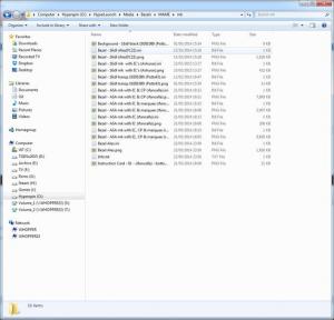

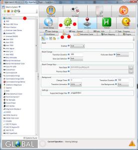

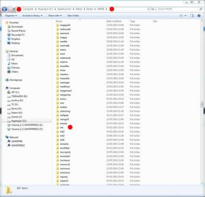

gigapig Posted March 12, 2015 Posted March 12, 2015 You switch bezels on here. They need to go in whatever system folder they are for in. :\Hyperspin\HyperLaunch\Media\Bezels\System Name\Game Name So if you need them for Mame here is my folder structure for my Mame bezels for HyperLaunch Notice the path at the top and I've marked the folder mk which is one of the Mortal Kombat games. And here is inside that folder with all the bezels in. If your using your own artwork you will need to create a bezel.ini so HyperLaunch knows where to place the game inside the bezel.
